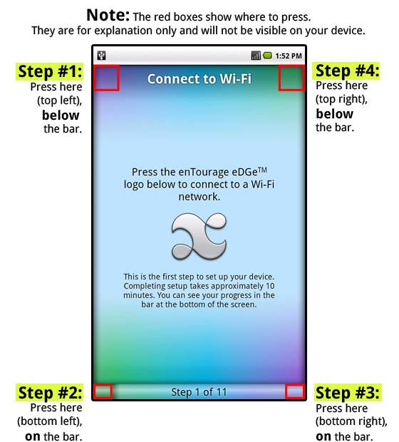

Angry entourage website...
Is likely gone. Over the last 3-4 days I have tried to access it to only get the timeout message. However, all is not lost the register screen can be bypassed by clicking in the LCD screen in a particular order as shown in the graphic.

I have a new PocketEdge - just arrived yesterday - and I would love to go to the "Welcome To Your PocketEdge" page that they show in the image, but I can't. It goes directly to the Connect to WiFi page, which starts the whole registration process. I've even tried resetting the darned thing - doesn't work. What am I doing wrong? TIA.

Oh thank you, thank you Gunner it worked. I am so happy!!!!!!!

In case you haven't gotten it yet, although perhaps you have! , follow Gunner's instructions from the Connect to Wi-Fi page. Once you have that page showing, click in the areas shown on the right-hand diagram in his post in the order it says to click. After that you won't be asked to register and you should have full functionality of your device.
