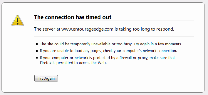

What you are trying to do will never work - Entourage closed the store when they closed up shop. The store app is a redundant appendage and all you can do is ignore it.

Angry entourage website...
Is likely gone. Over the last 3-4 days I have tried to access it to only get the timeout message. However, all is not lost the register screen can be bypassed by clicking in the LCD screen in a particular order as shown in the graphic.
