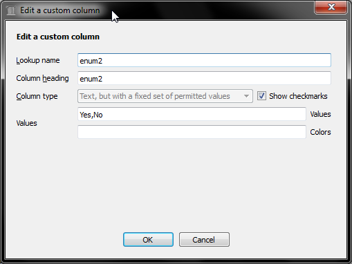

I am confused. Are you saying that when you edit a cell on the library view, you see three lines in the selection drop-down box, the first 2 blank and the third containing an x? If so, then something is very broken.
Attached is an image of what I see, along with an image of the column setup. What is different for you?

I remain confused. My problem is that the code should not be able to do what you are describing. There is (in theory) no way to get an icon into the drop-down box of an enumeration column (text with fixed set of values). There is also no way to get two empty values. The fact that you are seeing this means either a) we aren't talking about the same thing, b) calibre is seriously broken, or c) there are interactions that I don't understand. The last one is the most probable, but I wrote this code and I don't see how it can happen.
Can you post screen captures of your column definition and the open drop-down box?
