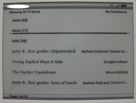

OK... so this is not perfect, but surprisingly usable. I've disabled the page-refresh-flash and cranked up the contrast, and my K3 (v3.1) is usable- if a little bit ugly.
I created a script, /etc/init.d/local that says
echo 19 7 > /proc/eink_fb/update_display
echo 1 > /sys/devices/platform/eink_fb.0/override_upd_mode
and from /etc/rc5.d, ln -s ../init.d/local S97local to start it at boot, but you could just type the echos from a shell to see the effect... It is in no-way permanent.
The "19 7" above sets contrast to an undocumented (very dark) setting, necessary to overcome the eInk - which has an almost mechanical latency to it and is too light otherwise. I found a pretty good bit of documentation, indirectly, in /opt/eink/scripts/diags.
I don't think Amazon will enable this as an option because there is a little bit of ghosting and overall ugliness to the display, but for me it works quite well, and the ultra-contrast actually makes many of my books easier to see in low light.
I've asked around to see if someone can help me get the eInk firmware from the new Nook STR (with it's proprietary anti-flash tech) to see if I can apply it to Kindle.
whatcha think?
UPDATE 8/4/11
Just a quick update before this thread fades into obscurity (or someone actually releases something : ) to save you the trouble of reading this whole boring development thread... Essentially we succeed to disable the screen flash, and solution is very usable.
If you read up to page three, you'll find a few different algorithms to change the way the eInk updates; there are essentially 3 update sequences with various effects. I hacked it, seaniko7 did the first proof of concept and made a video - http://www.youtube.com/watch?v=VN5fd3iBsMA
Various ideas were tried, in my opinion the current winning solution is mobad's script at
http://pastebin.com/pS83izMi
Enjoy, and thanks everyone for participating!

I should note that I'm using a B006 K3,
[root@kindle root]# cat /proc/eink_fb/commands_version
V0303 (C/S 0000EB65)
[root@kindle root]# cat /proc/eink_fb/waveform_version
V220_C049_60_WJ0F01_D (M24, S/N 1500, 85Hz)
"contrast level 7" seems to be a special 1 bit display mode, which interestingly, ignores /sys/devices/platform/eink_fb.0/override_upd_mode (which to get the following trick to work, should be left/put back at default... 0) Perhaps if a user-mode daemon was written to monitor page turns and fire the following "refinement":
echo 19 3 > /proc/eink_fb/update_display ; echo 18 0 > /proc/eink_fb/update_display ; echo 19 7 > /proc/eink_fb/update_display
firing this ^^^ after a page turn results in a 4bit grayscale refinement to the 1bit rendered page of contrast 7, it looks like there is still "1 bit" of ghosted afterimage but it looks good.
notes:
_EINK_UPDATE_DISPLAY_WHICH=18
_FX_UPDATE_PART=0
_FX_UPDATE_FULL=1
_FX_UPDATE_FAST=2
_FX_UPDATE_SLOW=3 - full refresh with "flash"
_FX_BUFFER_LOAD=99
_FX_DISPLAY_PART=100
_FX_DISPLAY_FULL=101

"Contrast: Off" = default
echo 19 0 > /proc/eink_fb/update_display
I think for now, we don't need to mess with /sys/devices/platform/eink_fb.0/override_upd_mode so just leave it at default 0 (ie: control is on/off)
After more testing, here is my summary:
"Contrast: 7" is a special case of the eInk contrast control, in that it sets the screen to display as 1 bit (hence very dark); This is the only contrast value which doesn't flash by default.
You mention the anti-alias. What I have found is that if after a page is drawn at contrast 7, you issue the following:
the anti-aliasing fills in, and the display looks normal. this happens very fast and is not (to me) nearly as visually distracting as the normal method of refresh. the display is not perfect; you can see a slight white-ghosting of the previous page, but to me it is less obnoxious than the flash. life is all about compromises. the good news is that (for me) the ghosting is not cumulative ie: does not get worse over time; so this wouldn't require a complete refresh every 6 pages like nook does.
what we need now is for some l33t h4x0r to write a simple script to monitor page turns and issue the above command or it's equivalent. It would be a great POC if someone could just tail /var/log/messages or whatever and fire whenever the page turns.
seriously guys, this could be awesome. let's do more than change screensavers!
