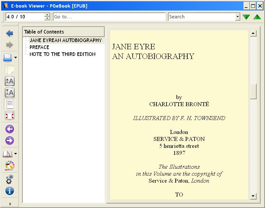

This RTF converts fine for me. See attached screencap. I've also attached the converted epub.
I'm also attaching the job details from my conversion. You could check it against your own conversion to see if you can tell where the differences in conversion settings might be.
