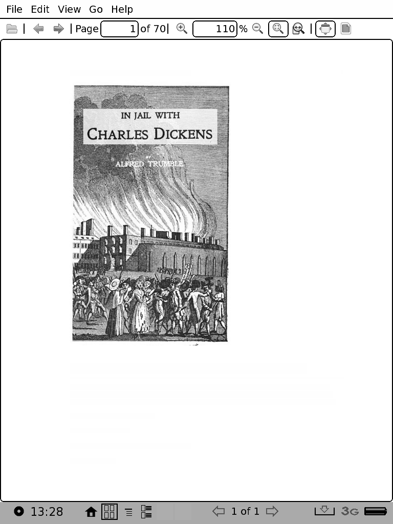

I had the cross-compiler hot... so here you have a quick & dirty compilation of epdfview v0.1.8 for the DRs.
It was very easy to build.
It feels quite slow on the emulator, and didn't load correctly all the .pdf I've checked.
Iņigo
