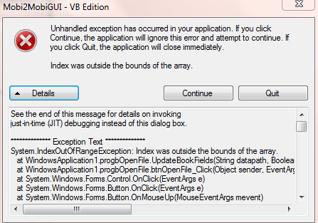

mobi2mobi error Windows 7
Ok, so I've attempted to fix this with all kinds of installs, previous versions, etc, but still can't get my mobi2mobi gui to work. I have a windows 7 PC with Mobi2Mobi_GUI_VB_v9 (previous versions 7 and 5) installed using PERL mobiperl-win-0.0.43 (attempted with 42, 40, etc). Windows 7 all ready has .NET 3.5. I receive the error below whenever I attempt to open an .azw file that I want to modify. Any help would be greatly appreciated. I prefer mobi2mobi to Calibre, so please assist!
Any azw... or just some?
Some azw's from Amazon have been slipping through with no Palm database name, and those books will result in the error you are seeing. Using the command-line mobiperl, you can give those azw's a Palm database name, and then the gui should be able to open them.
All of them.

Still worth a shot checking the database name with the command-line mobi2mobi, no? I just downloaded one of my newest Amazon purchases and I get the exact same error message you are getting (except that I'm still on Vista). Sure enough, the file has no database name. Giving it a database name with the command-line version of mobi2mobi makes the file then work fine with Mobi2Mobi-Gui .
By the way... I'm not sure what you're planning to do with mobi2mobi, but in case you're looking to change the clipping limit or TTS flag on DRMed Amazon azw files, that doesn't work anymore. If you change either of those records while the ebook still contains DRM, the ebook will be unreadable on your devices.
Just a heads-up, of course. You may have other needs that mobi2mobi will work fine for.

Yeah, that'd be great if I actually knew what you were talking about. How do I use the database with the command prompt? I've basically just gone off the "how-to" from the wikipage.

For simplicity's sake, put one of the azw files in the same folder as mobi2mobi.exe (not the gui program, the folder where all the mobiperl executables are). Then open a command prompt and change (cd) to that folder.
Typing:
mobi2mobi bookname.azw
...and hitting Enter will spit out everything that is known about the file. At the top of that list will be "Database name:" The title of the book (or part of the title) should appear there. If there is nothing there, then the file won't work with Mobi2Mobi-Gui. In that case:
Typing:
mobi2mobi --databasename "Some_Name 32_characters or less" --outfile "New ebook file name so I don't screw up the original one.azw" "bookname.azw"
...and hitting Enter will create a new azw file (with the name you gave for the --outfile parameter) that should work with Mobi2Mobi-Gui.
