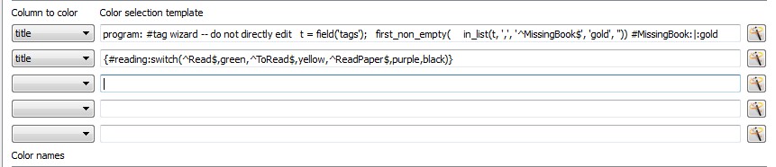

Using column to color can I use Title more than once
Eg First if tag is MissingBook then Title red
Second if Column is Read then title green
  Reply With Quote
Old 05-30-2011, 06:19 PM   #33
chaley
Posts: 12,529
Karma: 8075744
Location: Notts, England
Are you reporting a bug or making a comment? That aside, yes you can do this, and no you shouldn't be allowed to.
This dialog is changing quite radically. The new implementation will do something reasonable, either saying 'no' or using the first one that returns a value.

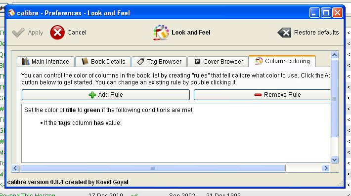

Old 06-03-2011, 06:04 PM   #39
Posts: 31,366
Karma: 62500000
The new interface is neat.
Question: is the (tag) Value: supposed to show the tagname I set?
I have a Tag <In Paper Library> that sets the Title to Blue (it works), but nothing shows for Value in the existing 'color the columns' display.
Old 06-03-2011, 06:08 PM   #40
Posts: 45,712
Karma: 28549306
Not sure what you mean, you mean the value <In Paper Library> is not shown in the list of rules?
Old 06-03-2011, 06:21 PM   #41
Posts: 31,366
Karma: 62500000
Correct. the value is shown is blank

Old 06-03-2011, 06:23 PM   #42
chaley
Posts: 12,529
Karma: 8075744
The renderer must think it is an html tag.
Old 06-03-2011, 06:25 PM   #43
Posts: 31,366
Karma: 62500000
I was thinking it might be something like that.
I think I chose that style of Tag so the "Catalog" would ignore it.
Old 06-03-2011, 06:34 PM   #44
Posts: 45,712
Karma: 28549306
Ah, HTML escaping will be added in the next release.
Old 06-03-2011, 06:45 PM   #45
Posts: 45,712
Karma: 28549306
@nyn: there was a bug when using "has" with a tags like column. I've uploaded a fixed build, so if you re-download and re-install and then re-create your rule which should then work as expected.
More generally, the fixed build also fixes a bug with "is set" and "is not set" rules and enables the use of composite columns in the rules.
Apologies, there were too many combinations for me to test them all before the release.
