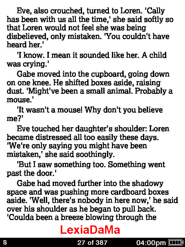

@font-face {
font-family: "LexiaDaMa";
font-weight: normal;
font-style: normal;
src: url(res:///Data/fonts/LexiaDaMa.otf);
@font-face {
font-weight: bold;
font-style: normal;
src: url(res:///Data/fonts/LexiaDaMa-Bold.otf);
@font-face {
font-style: italic;
src: url(res:///Data/fonts/LexiaDaMa-Italic.otf);
@font-face {
font-weight: bold;
font-style: italic;
src: url(res:///Data/fonts/LexiaDaMa-BoldItalic.otf);
body {
Edit: I installed the Palatino fonts from this site and they do work on my reader. It is quite similar to the default, but you can easily see the difference if you take a screenshot of the same page in the default font, or whatever other font you were using, and then Palatino.

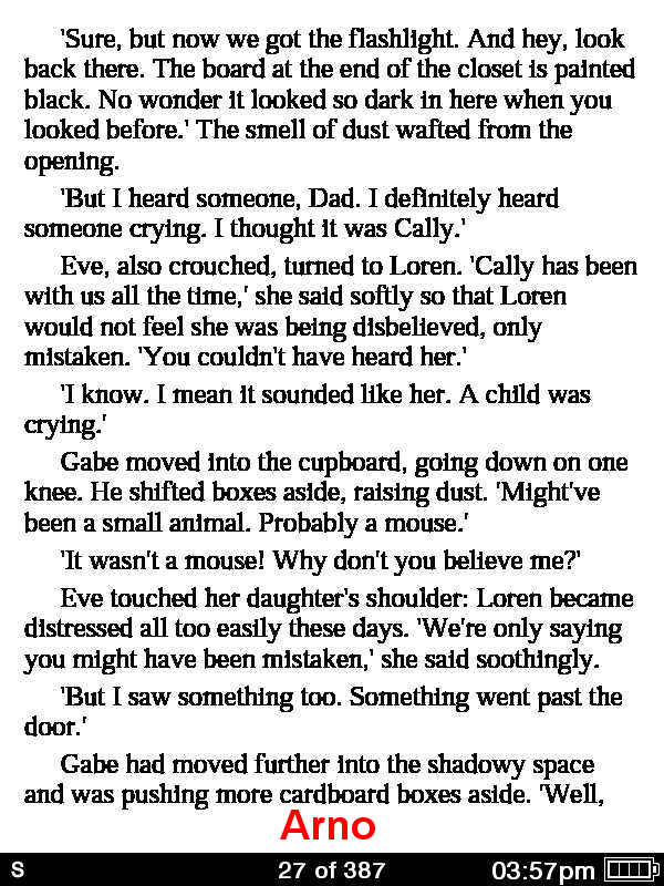

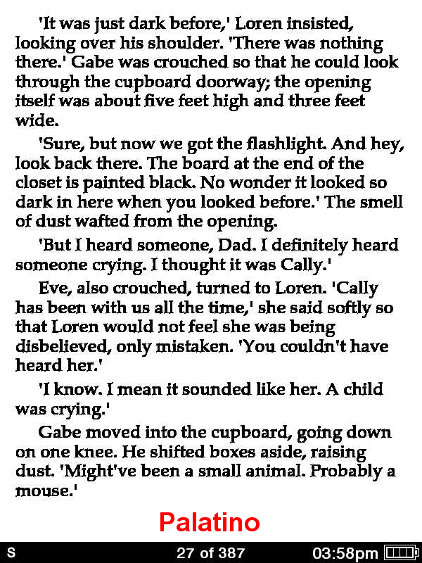

I've used Boroda's CFW in the past when PRS+ required it, but now PRS+ stands on its own and is self-installing and is really very nice. You can have as many custom stylesheets as you want for various fonts and can change them on the fly from Settings > PRS+ Settings > Book Viewer Settings > User EPUB Style (CSS Files), and then you have your list of files you've installed (I've included a screenshot of my list as an example, being able to take screenshots like this are part of PRS+). Simply select which one you want to use from the list. You just have to swap books by opening a different one, then go back to the one you had before to force the font change.
And both Arno and Palatino worked for me. I only used 4 from each font pack for normal and bold in regular and italic, and have screenshots of each plus default in small font. The font style differences are much more noticeable in medium font size though. The fonts I used were ARNOPRO-REGULAR.OTF, ARNOPRO-BOLD.OTF, ARNOPRO-ITALIC.OTF, ARNOPRO-BOLDITALIC.OTF, and PALATINOLTSTD-MEDIUM.OTF, PALATINOLTSTD-BOLD.OTF, PALATINOLTSTD-MEDIUMITALIC.OTF, PALATINOLTSTD-BOLDITALIC.OTF. I didn't rename them at all and they worked fine.
And I'll have to try adding !important to the css files and see if that really will overwrite those epubs that specify their own font. I always find those most annoying since I prefer LexiaDaMa still (including a sample of that font too just for comparison).
Edit: Btw, my reader viewing settings are at 127/-125, I didn't think to change that back to default before taking the screenshots, so they probably look more saturated than you're used to.

BTW, the fonts in the Arno and default screenshots you posted look identical to me, but Palatino is clearly different.
There is a difference in the Arno and default fonts. The default do not have true bold or true italics and while the bold is easy enough to simulate, the italic is not and doesn't look all that good. So Arno will have a proper italics.

You're right about Arno and Default after examining them closer and not between other fonts. I did more checking with the Sony default against Arno using the Windows font viewer for Arno, and while they do look pretty similar, there are certain letters, like the "j" that are distinctively different and it looks like the Arno font isn't loading for some reason. I tried renaming the files, using files from my Windows directory that I know work in applications on my PC, and couldn't get Arno to load on the reader for some reason. Really odd, never ran into that before.
I'll give your css a try and see if it'll overwrite the epubs with embedded fonts, thanks. And glad you gave PRS+ a try and like it, I thought you'd like the ability to swap fonts so easily.
Edit: I was able to override all embedded fonts (all that I've tested it on at least so far) by adding just the following to my .css files. I haven't needed all the spacing entries so far, but saved your complete file in case I ever run into instances where it is needed. Thanks for the info about using !important.
html {
font-family: LexiaDaMa !important;
.mainBody {
.calibre {
