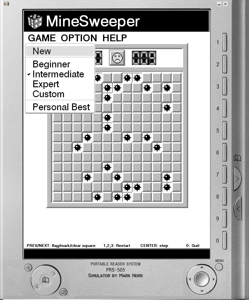

Originally Posted by surquizu View Post
Minesweeper does not work on the reader PRS-505. Appears on the menu of "Games and utilities" but not opens. Locks the reader.
I've set up my PRS-505 today with a custom build of PRS+2.0.11 + apps form the app-repository.
I can call Minesweeper and it didn't lock up the reader.
But if Minesweeper is called as very first app, init() seams to fail and the grid isn't filled. But exit via "0" is possible. Menus can be called too (and looks cool so far), but no options are set. So again there seams to be a fault in init.
Next start Calc and exit it.
Restart Minesweeper. Now everything is fine and playable
Though the about dialog didn't catch the center-button to close it.
Will have to digg further into this.
Mark
[EDIT]
Startup-Issue was caused by missing _icon and _titel in startup-code.
Finally figured how to set up a dialog-skin. Panels didn't react to custom code.
[/EDIT]

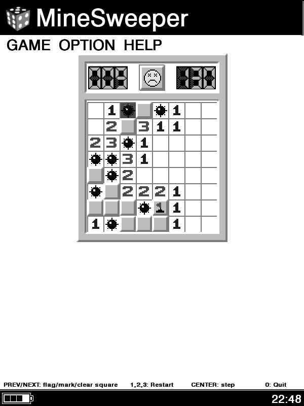

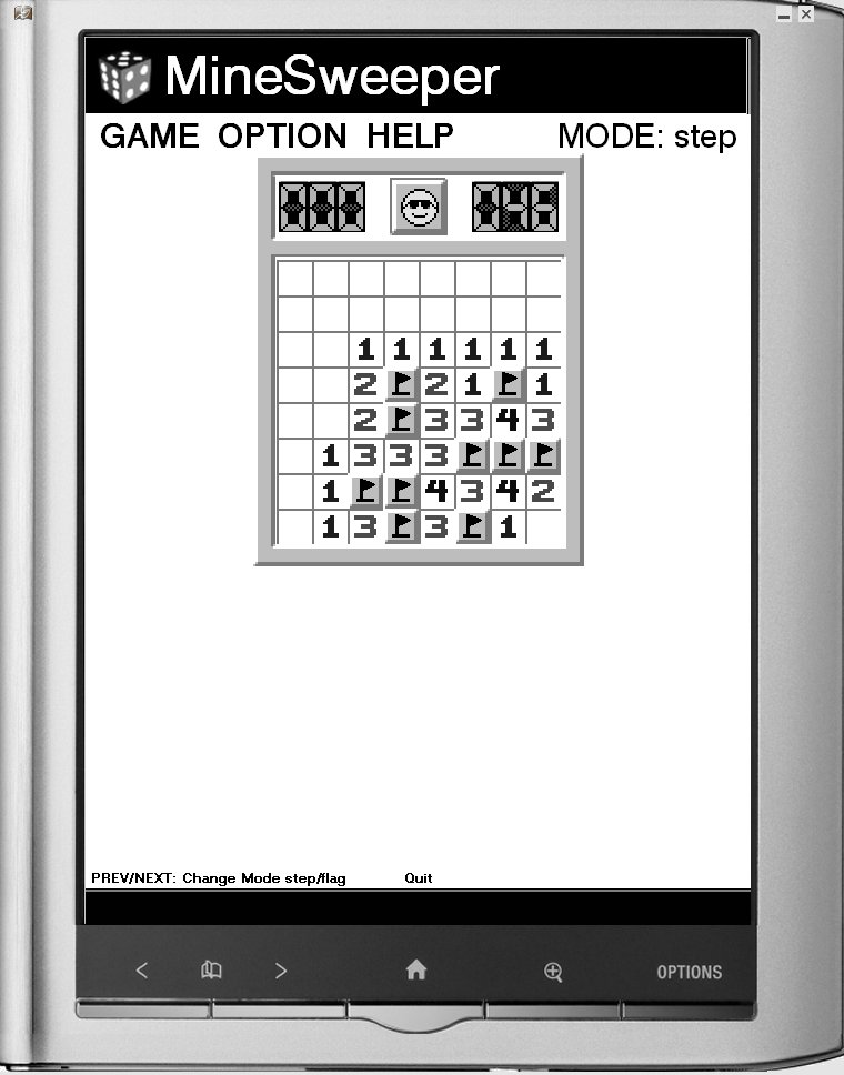

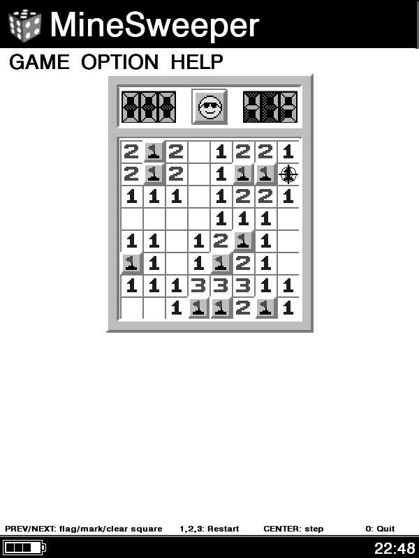

New Game MineSweeper
Originally Posted by Mark Nord View Post
Just to avoid redundancies, I've started on MineSweeper.
Finally MineSweeper reached publice beta state!
Code is pushed to the repository apps
Playable on all Sony-PRS with PRS+ 2.0.x (touch and non-touch)
(Checked with PRS-505, earlier versions reported to work on 350 and 600)
Nothing special, but
  • Some new code to get a popup-menu - lookalike on non-touch reader.
  • Some new code to interact with buttons on non-touch reader.
Possible enhancements: tick gameclock with hardware-timer for x50 models
Have fun
Mark

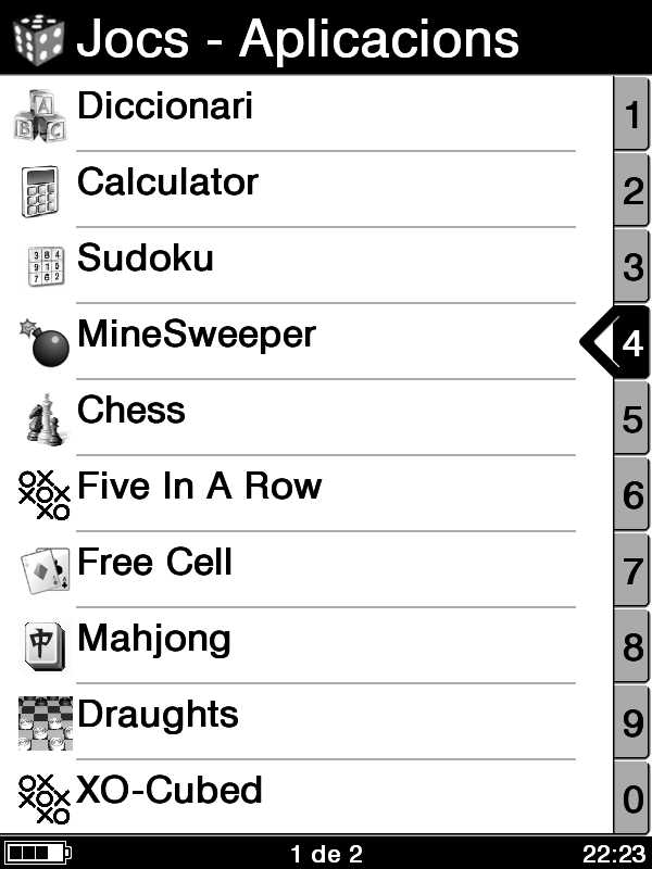

Works great on my 505. Thanks.
