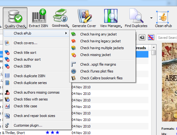

I'm not far away from releasing the next Quality Check version (got one more "Check" I am going to add related to navpoints in ncx files).
You can see something else in the top right that is also in progress...
@jackie/theducks - obviously the choice is entirely yours as to whether to do stuff manually or use a tool. Quality Check will allow you to "find" such cases without touching the files. Obviously my goal with the plugin that "fixes" the ePubs is that any changes it makes are done in the most conservative and safest way possible. It has to be a "no-brainer" decision for any feature that gets added to it.

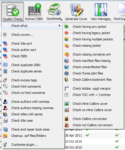

v1.5 Released
Changes in this release:
  • Move all the ePub checks onto a Check ePub submenu
  • Add epub check for legacy jackets only
  • Add epub check for missing container.xml files
  • Add epub check for files listed in manifest missing from epub
  • Add epub check for unmanifested files
  • Add epub check for iTunes plist files
  • Add epub check for Calibre bookmarks files
  • Add epub check for .xpgt margins
  • Add epub check for TOC with < 3 entries
  • Add epub check for inline Calibre cover
  • Add epub check for no inline Calibre cover
  • Add epub check for Calibre conversion
  • Add epub check for not Calibre converted
  • Add check for duplicate series index
  • Improve having jacket and multiple jacket checks to include legacy jackets
  • Restructure code internally for ease of future expansion
This started off as a minor release and become rather more.
Hopefully those of you who are concerned with the quality of their ePubs will find a few things to like out of that lot. Identifying is one thing - fixing will be another. As some will have gathered from the last few pages I have started another plugin which will allow automating the remedy for many of these items without requiring you to do a conversion.
Enjoy, I look forward to your feedback.

Do you know how much work you caused
I just did about 10 of the checks. (Using Natty Narwhal(32) today)
I opened a number of each type of error in Sigil.
Unfortunately, the report was correct
Kiwidude does it again
