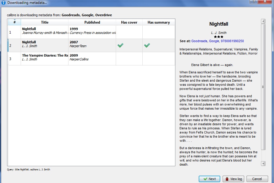

overdrive plugin
Is it possible to change the priority of one plugin over the other? I can never get overdrive plugin to work with other sources. When I select goodreads, google and overdrive as sources, the results never show overdrive under the "see at:" label in the metadata download window. It only shows when overdrive is exclusively used as the only metadata download source.
I can see the items that calibre download from overdrive using "view logs" but somehow it never combines and displays the results it gets from overdrive when using a combination of different sources. And it does not make a difference whether I select a few metadata fields or "download all metadata (slow)" from the configuration window for the overdrive plugin.

I didn't understand what you were referring to regarding 'See at' in your PM's, but I've just gone digging to try to find it. 'See at' has nothing to do with merging metadata, I believe it's a red herring. Overdrive doesn't support constructing a simple URL based on the Overdrive ID, so it can't return a URL for the Overdrive website like the other plugins do - that's all 'See at' does, is provide a link to the external website.
I just tried this with 'Return of the King' by Tolkien, and it gets all the info from Overdrive as expected. I think you need to be more specific with regard to what you're wanting to do. I believe based on the PMs we exchanged you only have Series selected in Overdrive, and you want that specific Overdrive metadata to be merged with other metadata sources.
As I noted in the PM before, specific details on what you have enabled, and what you wish to see, along with the logs would help a lot with assisting you.

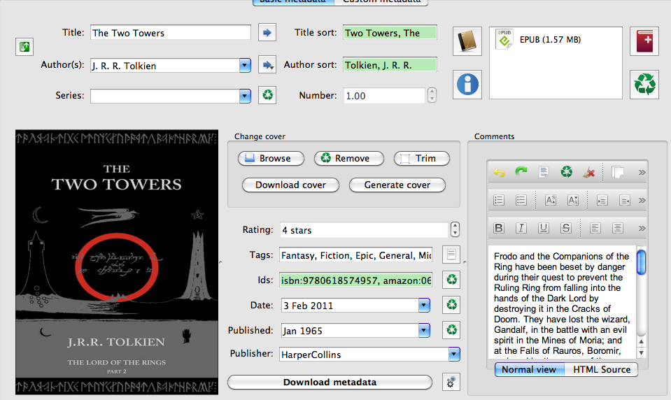

I just gave this another shot - all built-in metadata sources were enabled. All plugins had everything enabled except Overdrive, which only had Series and Tags enabled. Overdrive was prioritized for covers.
Based on the log and looking over the populated metadata it looks like only Google's results were used for the metadata, though Overdrive was used for the cover based on the priority. Neither Google or Amazon provided series data, but this wasn't merged from Overdrive even though it discovered it. Amazon Identifier was written to the Book Metadata, but Overdrive wasn't, so I suspect identify() had to go back to the web a second time to query for the cover instead of using the identifier cache, but I didn't do a detailed debug to check that.
Log:

    'Metadata object has no attribute named: '+ repr(field))
AttributeError: Metadata object has no attribute named: 'has_google_cover'
****************************** Overdrive ******************************
Request extra headers: [('User-agent', 'Mozilla/5.0 (Windows; U; Windows NT 6.0; en-US; rv:1.9.2.11) Gecko/20101012 Firefox/3.6.11')]
Found 1 results
Downloading from Overdrive took 5.46746611595
Title               : The Two Towers
Author(s)           : J. R. R. Tolkien
Publisher           : HarperCollins
Series              : Lord of the Rings #2
Identifiers         : overdrive:57844706-20fa-4ace-b5ee-3470b1b52173
****************************** ISBNDB ******************************
Request extra headers: [('User-agent', 'Mozilla/5.0 (Windows; U; Windows NT 5.1; en-US) AppleWebKit/534.3 (KHTML, like Gecko) Chrome/6.0.472.63 Safari/534.3')]
Found 2 results
Downloading from ISBNDB took 10.7118799686
Publisher           : Boston : Houghton Mifflin Co., [1994], c1954.
Identifiers         : isbn:9780618129089
Comments            : The battle for Middle Earth intensifies as Frodo and Sam travel to Mordor with Gollum, and the other members of the Fellowship fight the machinations of Saruman.
Title               : The Two Towers, 1954
Author(s)           : John Tolkien
Publisher           : AST
Identifiers         : isbn:9785170162758
Comments            : This page was created by "Islander-Book". The Two Towers John Ronald Reuel Tolkien - 5170162758 - 9785170162758 - Russian books.
****************************** Amazon.com ******************************
Found 5 results
Downloading from Amazon.com took 11.2579109669
Title               : The Two Towers: Being the Second Part of the Lord of the Rings
Publisher           : Mariner Books
Language            : en
Rating              : 4.6
Published           : 2005-06-01T00:00:00+00:00
Identifiers         : amazon:0618574956, isbn:9780618574957
Comments            :
From Library Journal
New Line Cinema will be releasing "The Lord of the Rings" trilogy in three separate installments, and Houghton Mifflin Tolkien's U.S. publisher since the release of The Hobbit in 1938 will be re-releasing each volume of the trilogy separately and in a boxed set (ISBN 0-618-15397-7. $22; pap. ISBN 0-618-15396-9. $12).
Copyright 2001 Reed Business Information, Inc.
Review
"Tolkien's invention of strange peoples, curious incidents, miraculous doings, is poured out in this second volume of his trilogy as exuberantly and convincingly, in a dreamlike way, as ever. As the story goes on the world of the Ring grows more vast and mysterious or comic. The story is superb." The Observer
Title               : The Lord of the Rings
Author(s)           : J. R. R. Tolkien & Alan Lee
Publisher           : Houghton Mifflin Harcourt
Language            : en
Rating              : 4.6
Published           : 2002-11-03T00:00:00+00:00
Identifiers         : amazon:0618260587, isbn:9780618260584
Comments            :
Review
"A work of immense narrative power that can sweep the reader up and hold him enthralled for days and weeks." The Nation
Author(s)           : J. R. R. Tolkien (author)
Identifiers         : amazon:B003N7UR96
Title               : The Lord of the Rings: The Two Towers
Publisher           : Ballentine Books
Language            : en
Published           : 1965-01-01T00:00:00+00:00
Identifiers         : amazon:B003H72G78
Title               : The LORD OF THE RINGS. Three Volumes. THE FELLOWSHIP OF THE RING. THE TWO TOWERS. THE RETURN OF THE KING.
Author(s)           : J. R. R. Illustrated By Francis Mosley. Drawings By Eric Fraser. Tolkien
Publisher           : Folio Society
Rating              : 5.0
Published           : 2004-05-03T00:00:00+00:00
Identifiers         : amazon:B0012KRR80
Trying alternate results page markup
No matches found with identifiers, retrying using only title and authors
The identify phase took 14.85 seconds
The longest time (14.694492) was taken by: Google
Merging results from different sources and finding earliest publication dates
We have 12 merged results, merging took: 7.61 seconds
****************************** Google Covers ******************************
Failed to download valid cover
Took 0.615519046783 seconds
Downloading cover from: http://books.google.com/books?id=EqgV2wJhi1cC&printsec=frontcover&img=1
Failed to download cover from: http://books.google.com/books?id=EqgV2wJhi1cC&printsec=frontcover&img=1
  File "/Users/lee/calibredev/heuristics/src/calibre/ebooks/metadata/sources/google.py", line 240, in download_cover
    cdata = br.open_novisit(cached_url, timeout=timeout).read()
  File "site-packages/mechanize/_mechanize.py", line 199, in open_novisit
  File "site-packages/mechanize/_mechanize.py", line 255, in _mech_open
httperror_seek_wrapper: HTTP Error 404: Not Found
****************************** Amazon.com Covers ******************************
Downloaded cover: 328x500
Took 1.74086594582 seconds
Downloading cover from: http://ecx.images-amazon.com/images/I/517KYu2KtKL..jpg
****************************** Open Library Covers ******************************
Request extra headers: [('User-agent', 'Mozilla/5.0 (Windows; U; Windows NT 5.1; en-US) AppleWebKit/525.19 (KHTML, like Gecko) Chrome/0.2.153.1 Safari/525.19')]
Downloaded cover: 314x500
Took 1.43604588509 seconds
****************************** Overdrive Covers ******************************
Downloaded cover: 510x664
Took 11.0059170723 seconds
No cached cover found, running identify
Downloading cover from: http://images.contentreserve.com/ImageType-100/0292-1\{F7D04E28-1A33-4579-B6A6-B6CD2A8BAC10}Img100.jpg
Download complete, with 0 failures

I'm not sure how calibre comes up with the published year '2007'. However, from going through the whole log, I think the earliest publication year is '2009' from HarperCollins. Please see attached pic below.
Starting download
Query: title:Nightfall; authors:L. J. Smith
Running identify query with parameters:
{u'authors': [u'L. J. Smith'], u'identifiers': {}, u'timeout': 30, u'title': u'Nightfall'}
Using plugins: Goodreads, Google, Overdrive
The log from individual plugins is below
****************************** Goodreads ******************************
Found 1 results
Downloading from Goodreads took 7.64499998093
Title               : Nightfall
Author(s)           : L. J. Smith
Publisher           : HarperTeen
Tags                : Young Adult, Fantasy, Romance
Series              : The Vampire Diaries: The Return #1
Rating              : 3.63
Published           : 2009-02-10T00:00:00+00:00
Identifiers         : isbn:9780061720772, goodreads:3934321
Comments            : <p>SUMMARY: Elena Gilbert has been through it all: She has fallen in love, fought ghastly evil, become a vampire, died, and then returned from dead. And now, torn between the love of two vampire brothers, she must face an ominous new danger. A demon has descended on the quiet hamlet of Fell's Church and seized the minds of numerous young girls. As his power grows, it becomes frighteningly apparent that this infernal force will ultimate threaten the whole world. This enthralling trilogy series extends L.*J. Smith's teen-pleasing Vampire Diaries series. Addictive suspense.</p>
Querying: http://www.goodreads.com/search?search_type=books&search[query]=Nightfall+Smith
Goodreads book url: u'http://www.goodreads.com/book/show/3934321-nightfall'
Request extra headers: [('User-agent', 'Mozilla/5.0 (Windows NT 6.1; Win64; x64; rv:2.0.1) Gecko/20100101 Firefox/4.0.1')]
Found 1 results
Downloading from Overdrive took 29.4869999886
Title               : Nightfall
Tags                : Fiction, Horror, Romance, Young Adult Fiction
Language            : en
Published           : 2009-01-03T13:00:00+00:00
Identifiers         : overdrive:2d5e943d-35c1-4714-a31a-a39222c9cc8e, isbn:9780061904110
Comments            : <blockquote><p>Elena Gilbert is alive — again.</p></blockquote><p>When Elena sacrificed herself to save the two vampire brothers who love her — the handsome, brooding Stefan and the sleek and dangerous Damon — she was consigned to a fate beyond death. Until a powerful supernatural force pulled her back.</p><p>Now Elena is not <em>just</em> human. She has powers and gifts that were bestowed on her in the afterlife. What's more, her blood pulses with an overwhelming and unique force that makes her irresistible to any vampire.</p><p>Stefan wants to find a way to keep Elena safe so that they can make a life together. Damon, however, is driven by an insatiable desire for power, and wants Elena to rule as his princess. When Stefan is lured away from Fell's Church, Damon seizes his chance to convince her that he is the brother she is meant to be with. . . . </p><p>But a darkness is infiltrating the town, and Damon, always the hunter, is now the hunted; he becomes the prey of a malevolent creature that can possess him at will, and who desires not just Elena's blood but her death. </p><p><strong>The first book in a new trilogy from L. J. Smith!</strong></p>
****************************** Google ******************************
Found 5 results
Downloading from Google took 7.68000006676
Title               : Nightfall
Author(s)           : Joanna Murray-smith & Monash University. Playbox Theatre Centre
Publisher           : Currency Press in association with Playbox Theatre Centre, Monash University, Melbourne
Tags                : Australian Drama, Drama, General, English; Irish; Scottish; Welsh
Published           : 1999-12-01T10:25:09.143000+00:00
Identifiers         : google:J8R0AAAACAAJ, isbn:9780868195919
Comments            : The doorbell rings. They open the door. On the porch stands a young woman. Emily and Edward Kingsly have dreamt of this night for seven years. At the same time, however, they have shared the dread that their dream may turn into a nightmare. But nothing could have prepared them for the decision they must face which will change the nature of their relationship forever. Murray-Smith closely examines family, love and commitment with her characteristically sharp insight in this taut and compelling new drama.
Title               : Nightfall
Author(s)           : Lisa J. Smith
Tags                : Interpersonal Relations, Supernatural, Vampires, Family & Relationships, Interpersonal Relations, Fiction, Horror
Published           : 2009-05-15T10:25:06.675000+00:00
Identifiers         : google:aN-wx4yFNWgC, isbn:9780061720772
Comments            : After returning from the afterlife, Elena is forced to battle an ancient evil when Stefan, her vampire boyfriend, goes missing.
Title               : Nightfall
Publisher           : HarperCollins Publishers Limited
Tags                : Fiction, Science Fiction, General
Published           : 2010-01-01T10:25:05.973000+00:00
Identifiers         : google:GJ8lQwAACAAJ, isbn:9780061990250
Title               : The Vampire Diaries: The Return: Nightfall
Tags                : Brothers, Demoniac Possession, Horror Stories, Interpersonal Relations, Fiction, Supernatural, Vampires, Fantasy, General, Juvenile Fiction, Horror & Ghost Stories, Love & Romance, Fantasy & Magic, Horror
Published           : 2009-12-23T10:25:08.354000+00:00
Identifiers         : google:jesAXgTdFdoC, isbn:9780061720802
Comments            : To save the two vampire brothers who love her, Elena Gilbert sacrificed her life.   Now that a supernatural force has brought Elena back from the dead, all handsome, brooding Stefan wants is to keep her safe. But when he is lured away from Fell's Church, sleek, powerful Damon seizes his chance to win Elena over, unaware of the danger they're both in. A malevolent being has infiltrated the town and is growing stronger. Able to possess Damon at will, the creature is also drawn to Elena and the new power she has acquired. But it's after more than Elena's power: It thirsts for her death.   Elena's story continues in shadow souls!
Title               : Andrew Gadd: Nightfall
Author(s)           : Edward Lucie-smith & Thomas Agnew (london)
Publisher           : Agnew's
Published           : 1998-05-15T10:25:10.206000+00:00
Identifiers         : google:JhPjSAAACAAJ
The identify phase took 29.63 seconds
The longest time (29.487000) was taken by: Overdrive
We have 3 merged results, merging took: 0.00 seconds
Calibre queries a database called xisbn to find all the associated editions of the book, and then populates the published date with the earliest published version.
ldolse is offline   Reply With Quote
