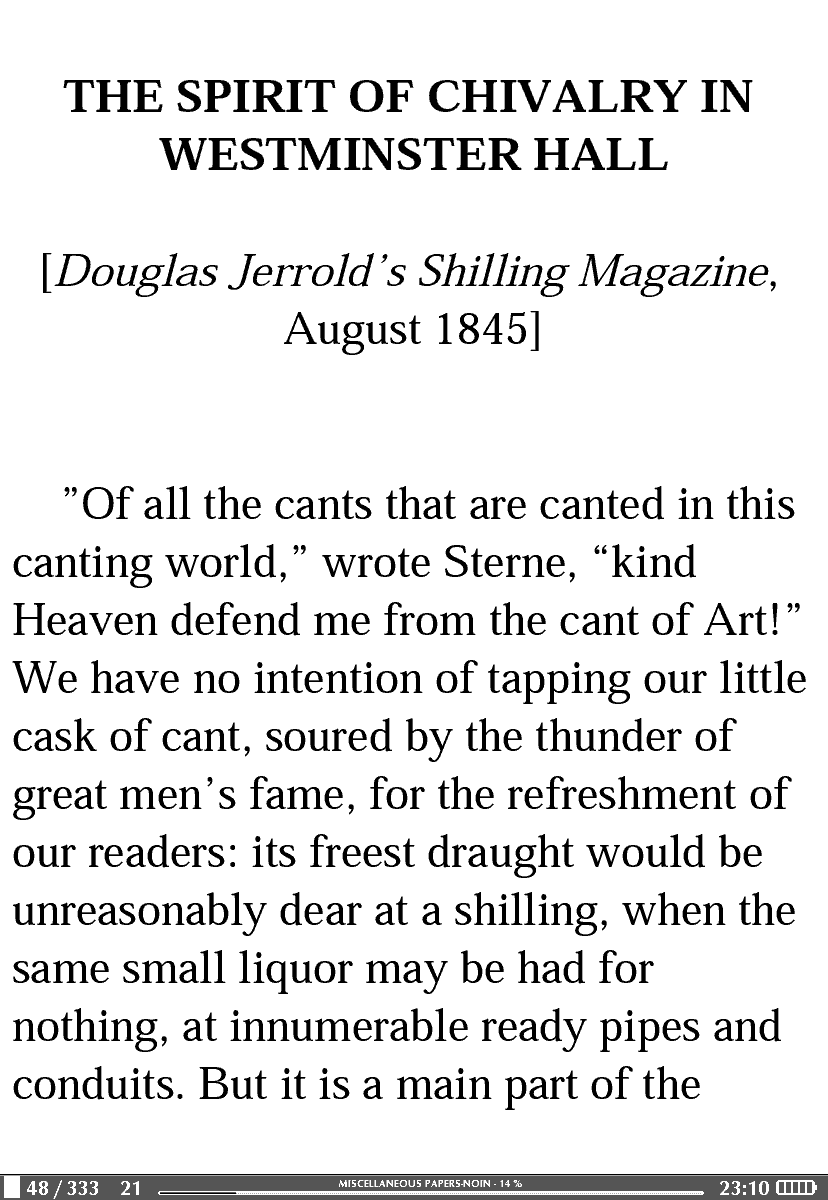

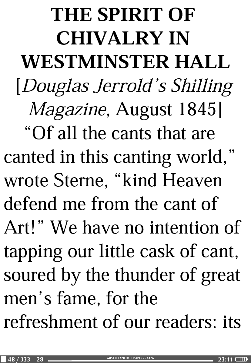

I think it works. It's easiest to go to the chapter "The Spirit of Chivalry in Westminster Hall". The first sentence after the heading has quotations at the beginning and inside a paragraph.
(~-indent has "real" indents, ~-noin has non-breaking spaces)

Unfortunately I don't have an ePub reader at hand as I write this. Do you mean that the real indent version has the smartquotes right, but the "spaces" version doesn't?

Yes, that's what I mean. If you have no ePub reader at hand, here are two screenshots:

If that's the case you should be able to use the 'replace entity indents' option under heuristics to replace all entity indents with css indents to ensure that non-breaking spaces don't screw up smarten punctuation.
