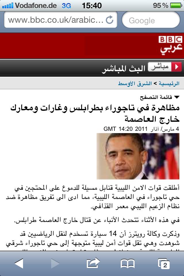

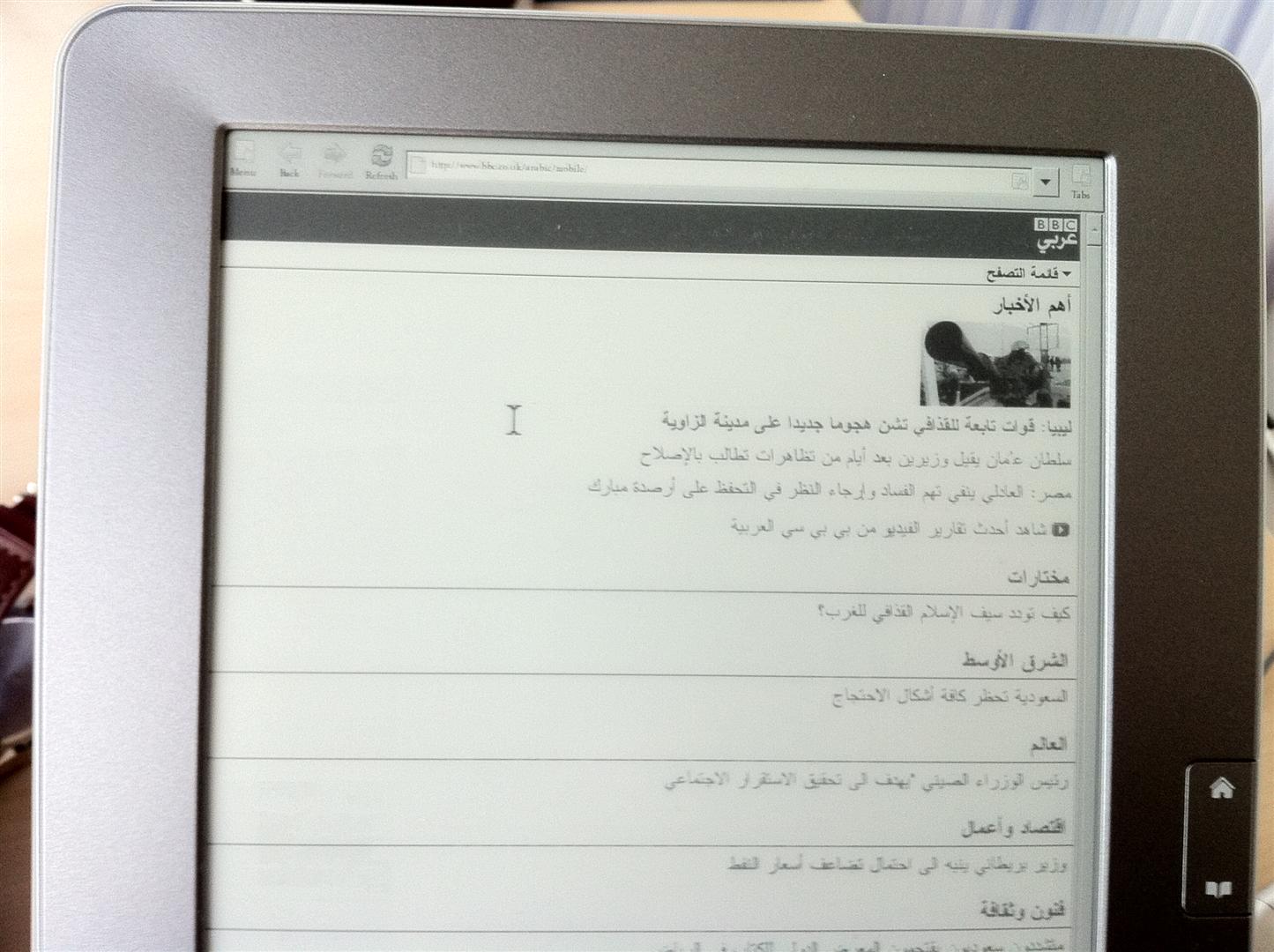

Hi Experts,
I bought this week the PB 903, which is really an excellent device . One of the important reasons why I ordered this reader was to read news paper in the web, it looks fine except the issue of displaying Arabic Web Pages:
Arabic alphabets appear in the right order (from right to left) BUT letters are separated!!
I am attaching 2 screenshots of a web page (Arabic BBC) and how it appears on the BP reader and same page on my iPhone
Even tried to change the language of the device from English to Arabic did not solve the issue
Can you please advise what I can do in order to get Arabic HTML pages displayed correctly?
PS: I have seen there is an option in the web browser under encoding to select "Custom" Is there a way to add manually any files there which would help
to read Arabic properly?

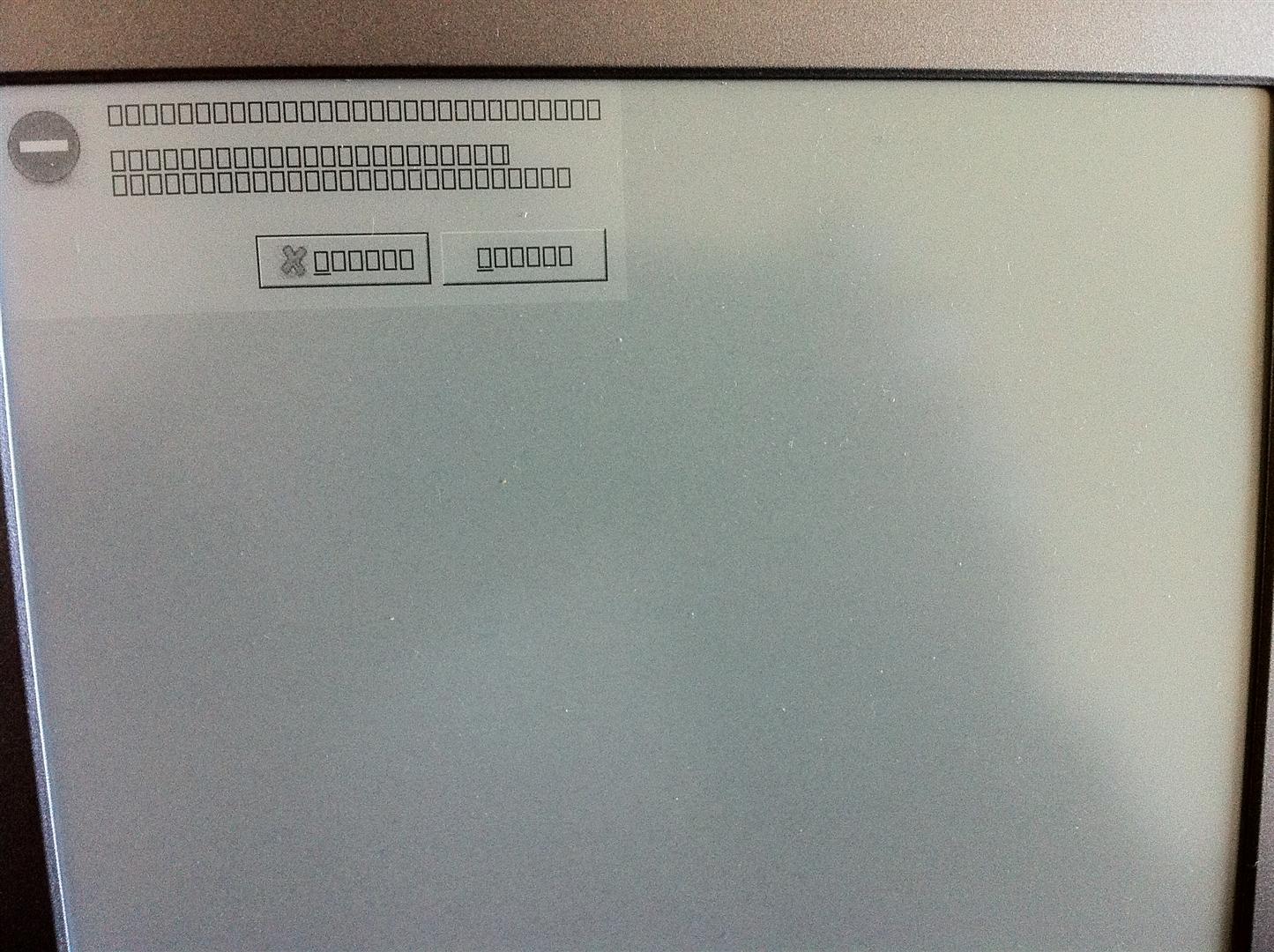

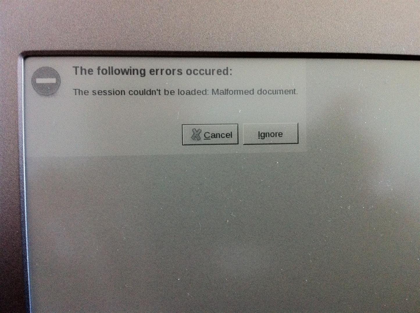

My quick update: I tried the new "webbrowser-enhanced_arabic-test.app" and got strange encrypted error, when I clicked "ignore" the browser opened for a a few seconds with a strange GUI and was closed afterwords
Now even my original "webbrowser-enhanced.app" starts with an error message which I can ignore and continue working with the browser
I attached related screens,
Thanks for the help again!!!

Good news!! I got now the browser and I can select additional fonts in the browser and Arabic displaying is correct!!!
I am still testing the menu where you can select the fonts in the browser (fixed size font, default font family) I need to know how they affect the behavior. As now the menu text in the browser (menu, back, refresh, stop,...) appear too small.
I will give you another update later, Big Thanks again to doublezed
