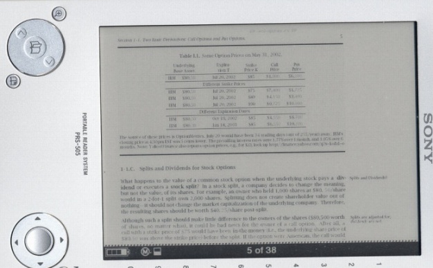

Attached is a scan of your PDF file in landscape mode. It is in the M (Medium) font. you cannot get any larger with PDF.
My tired old eyes cannot read this with my glasses. Using a magnifying glass, it is possible to read. However, I notice the page turns slowed up a bit when tying to page rapidly. Turning at a "normal" read was still a bit slower than you would expect with an eBook.
Overall, the Sony does a VERY poor job of displaying PDF files!
I will add this: What the reader does display is an exact copy of the PDF file. You have it just as it appears on the computer screen. Just too small to read and no option to make it larger even with scrolling which is not available with the PDF.

I would wait for the new Sony 505 firmware update coming out soon (date unspecified).
This new update is supposed to give better pdf support among other things.
I have the Sony 505. I downloaded the web-options.pdf link from the start of this thread, and ran it
though several programs. I got the best results from a conversion program called RasterFarian,
which converts the pdf as a rasterized sony reader ebook lrf file.

I was able to read your pdf ok with the Sony 505 screen in Landscape mode.. The print was on the small
side. The print was bigger then a home mortgage contract or a prescription medicine disclaimer.
