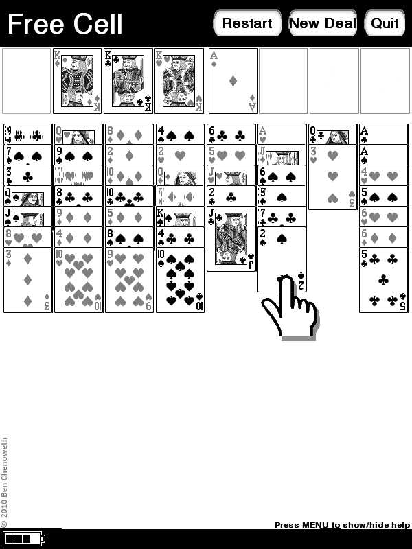

New game: Free Cell
Anyone for Free Cell? I know it's a bit of an oldy, but since almost every game is winnable, it makes for a great game...
Enjoy!
Unfortunately, this didn't work when I tried loading it on my PRS-600. It works fine in the Test Environment, in both Touch and non-Touch modes. But my reader just froze when I clicked on its menu entry.
If anyone can find the bug, I would be very grateful!
I think the error is in the name of the folder. Change FreeCell by Freecell. So worked fine in the prs-505
