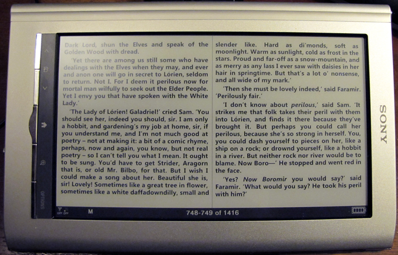

@SeaBookGuy, the attached photo shows why I like the 950 for reading ePubs in landscape with two column mode. It also shows the customized fonts. I know this is not appealing to everyone, but I like the feel of the 950 in landscape and the look of two columns, and being a lefty I find the buttons easy to use for page turning when I hold it that way.
