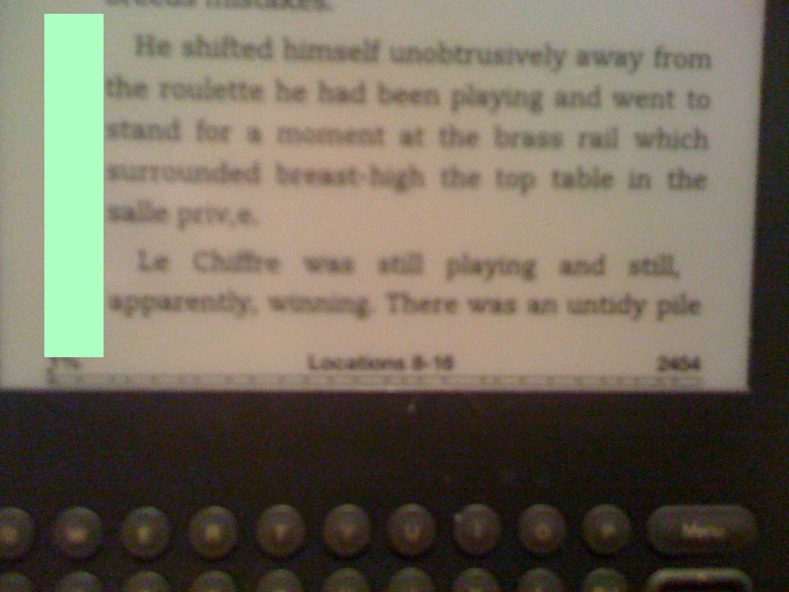

Hi Guys,
I am pretty new to the conversion software (Calibre).
I have some books in Epub format that I want to transfer to my Kindel, I am doing this by covertng the EPUB file to a Mobi File, and then renaming the extension of .AZW, this all works fine and the software is great.
I do have a problem though with the left margin when they turn up in the kindel the text appears to have a tab or something on it, that is forcing the main body of the text out by a couple of centimeters. (I have included a picture)
I converted the same file to PDF & sent to amazon to convert to an AZW and whatever they have done gets the text to be in the correct position.
Does any one have any ideas on how I can get this sorted in Caliber, I have tried most of the settings, removing the cover picture, removing TOC etc etc nothing seems to fix it.
Thanks
Rob

This is an inherent problem with the kindle's handling of margins. Is your output profile set to Kindle? If so Calibre will handle the conversion a bit differently to address the problem, but some epub files have really large margins, so it will still look about like your screenshot.
To completely get rid of the margins you need to edit the epub in Sigil and get rid of the margins in the css. There are several other threads discussing this in more detail if you need more help. Try this one to start:
https://www.mobileread.com/forums/sho...de+left+margin
