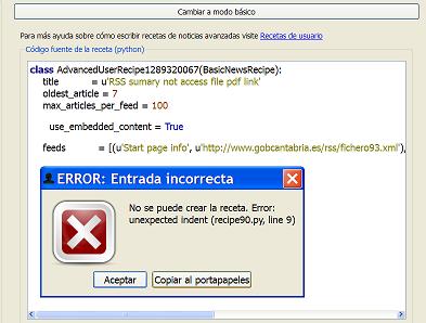

But see img when insert your code:
Name:	RSS crask not link pdf.JPG
My Spanish is rusty, but I'm pretty certain it's telling you that you made a mistake when you inserted the line of code I posted. You have indented it incorrectly. Do not use tabs, and give it the same indent as oldest_article = 7.

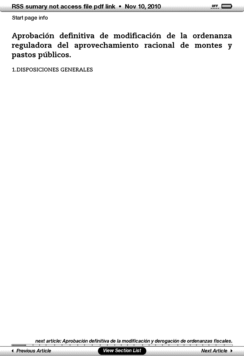

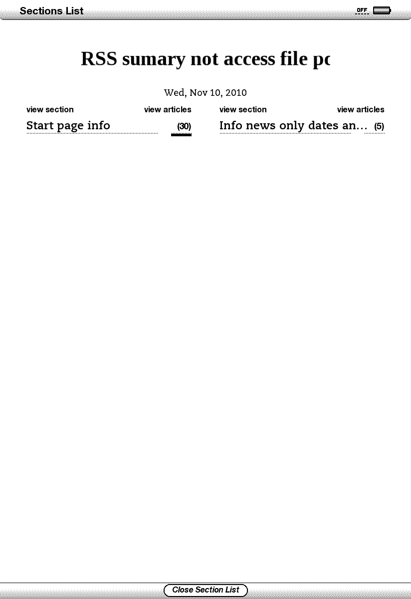

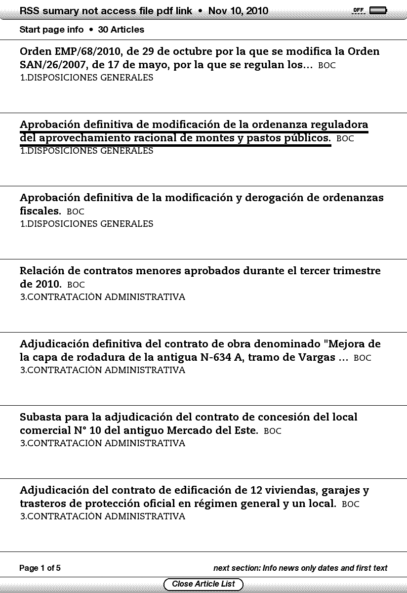

ok, fine, look at the pictures, are in Spanish, but just wanted to indicate that the recipe out file now weighs a few bytes and also is very quick to execute.
main image, product selection, open text article, "but not open" code .... pdf
(now, not see a big text "%PDF-1.4 %âãÏÓ 2 0 obj endobj 1 0 obj/M(D:201", when select article)
thanks
ID:	60965   Click image for larger version
ID:	60966   Click image for larger version
