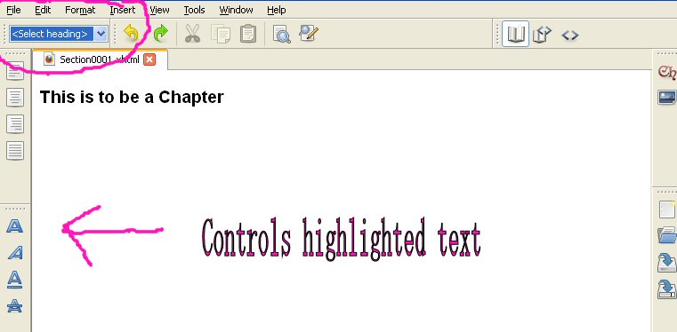

What you see (mode: BV or CV) depends on what mode was opened last.
Change your view with the buttons
The TOC is simple, if you keep in mind the word: NESTED
Place the cursor on (do not highlight the text) the text to ALSO be used for the TOC entry, pull down the selection box (defaults to normal if the insert point is not in a header) and select your header level.

TOC Editor is for AFTER you set headings in you document. in Book view.
Note: that my button locations have been moved from default.
Use the <select Heading> tool to pick a level. Note if your insert point is PROPERLY (to set it) on the text, this may say Normal.

Thank you, I just figure out what you were telling me in the previous posting, then you added more details. Thanks again, it works
