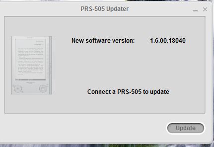

Nothing? So you ran the program and nothing happened at all? Odd.
When I run the program I'm greeted with an opening screen: Pic1 (see attachment pic1.jpg). I agree to Sony's terms, if my reader is not connected I see Pic2a (see attachment pic2a.jpg) -- if my reader is connected I see Pic2b (see attachment pic2a.jpg)
As I said, this is a Windows program. Since you're on a Mac, hopefully you're using VMWare, Parallels, or another virtual environment to run it. If so, and you still see "nothing" when you click the file, try downloading another copy.
When I connect my reader to my laptop I get an "no name" icon. I open that and inside is a "protected" file.
You want to be here (see the quote above) when you start to flash your Reader.
ID:	59094   Click image for larger version
ID:	59097   Click image for larger version
