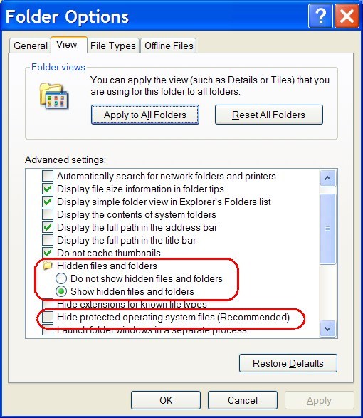

They exist or it wouldn't produce the error the way it did. I'm guessing they're hidden. In explorer go to Tools - Folder Options and unhide the files (See attached).
ID:	57427   Click image for larger version

I'm telling ya, they aren't there. And if they are there, windows isn't telling me...
I have Show Hidden and Show System files checked. I used Windows Explorer and it didn't show them. I used a CMD prompt with admin privliges and that's a no go. (I attached the results in a .txt file via dir > txtfile)
