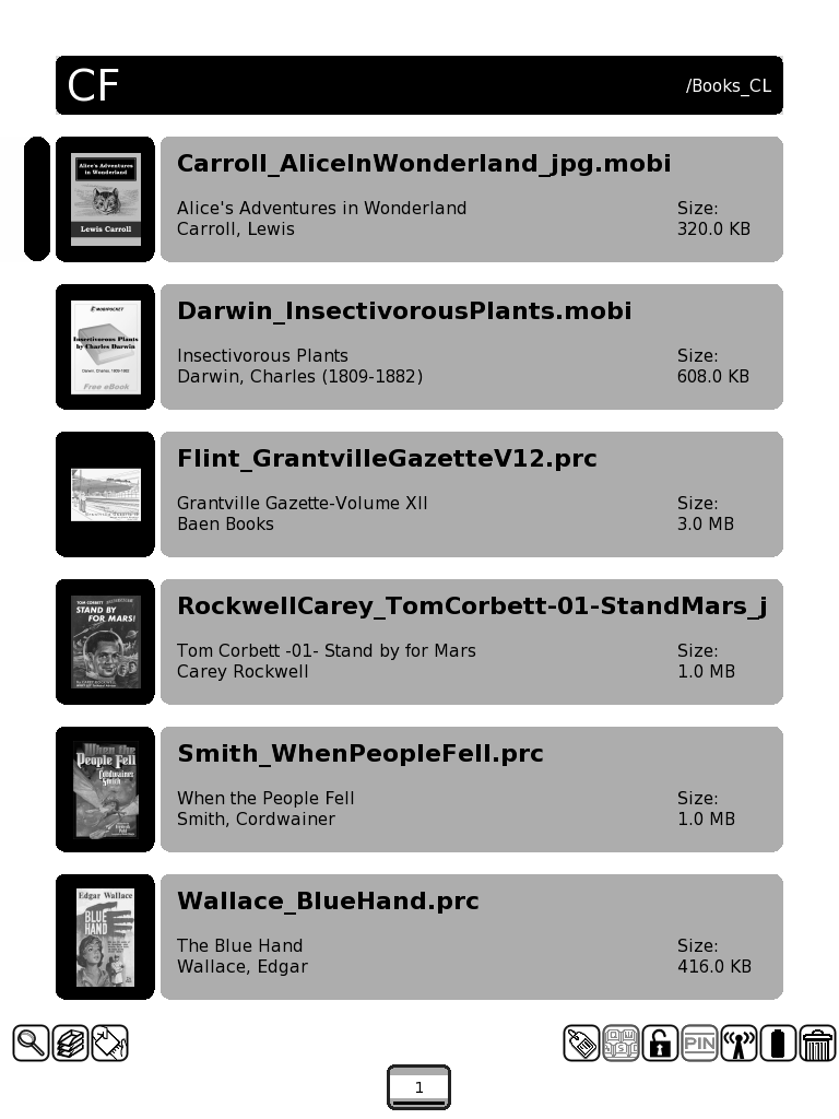

The 3 attached screenshots illustrate the issue.
The 1st shows files that have been copied to the CF card, but not opened. In some cases the contentLister lists the book's title but in other cases it lists the books filename.

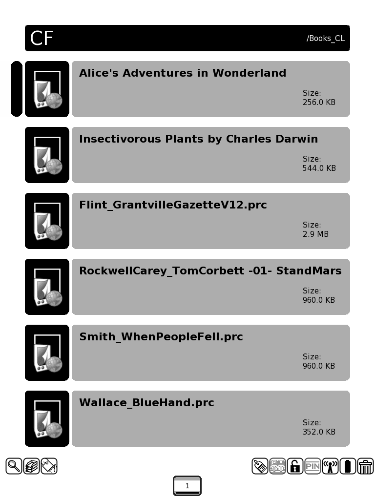

The 2nd shows what happens after the files have been opened by the MobiPocket Reader. They are now in individual subdirectories, and in all cases the contentLister lists the books filename (which is also now the subdirectory name). This is because that is how the MobiPocket Reader has configured the manifest.xml files.

Note that all this information, including the cover image (in most cases) is in the .prc or .mobi file. There is no reason why the MobiPocket Reader could not produce a layout like the 3rd screenshot instead of the 2nd screenshot.
As usual, depending on your browser defaults, you may need to click on the expanded image again to get the full sized screenshot.
