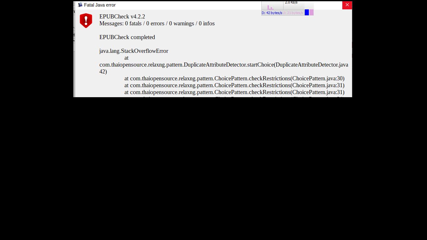

My old Windows 7 PC recently broke down and I have replaced it with a shiny new Windows 10 PC.
I have been rebuilding my set of software and learning about Windows 10 this last two or three weeks and have hit a problem I have been unable to fix.
Calibre and the plugins I use were almost the first things I installed.
Now I come to try and use Calibre and ePubCheck I keep getting the following error message.
Name:	Error Message.jpg
I have tried reinstalling ePubcheck, Calibre and Java but nothing I have tried works (all the latest versions).
The version of ePubCheck in my installation of Sigil is working correctly.
My system Windows 10, with the latest versions of Java, Calibre and ePubcheck.
Any help would be appreciated
Thanks

Device: Kindle PW2
1. Open the Calibre plugins folder (Preferences > Miscellaneous > Open Calibre configuration directory).
2. Double-click plugins.
3. Open EpubCheck.json
4. Change the following entry:
  "is32bit": false,
to
  "is32bit": true,
  "is32bit": false,
to
  "is32bit": true,
Thank you.
That was very easy. My struggles with Windows 10 getting things how I want them were not so easy.
Still I am learning which keeps me happy.

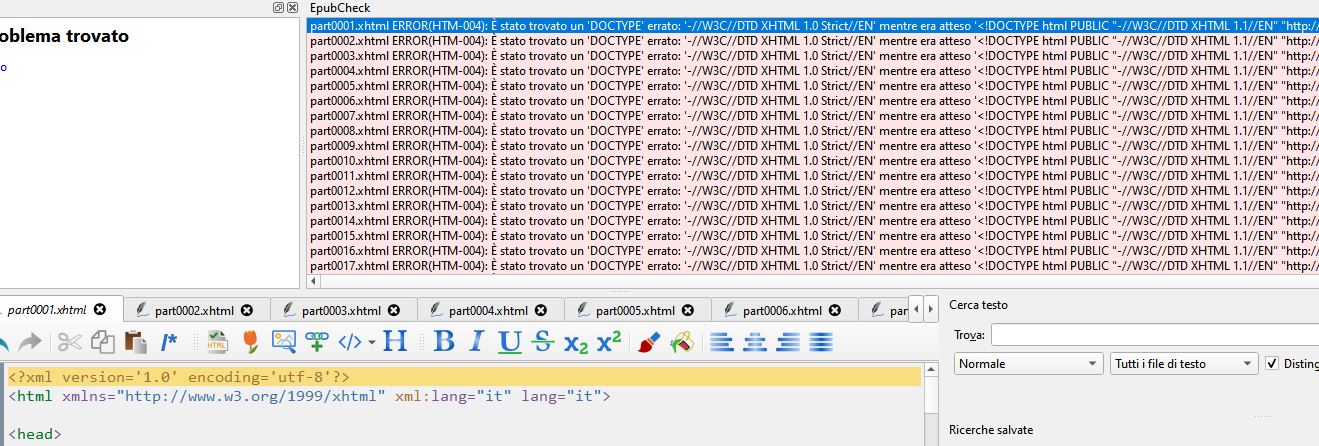

Hi, using EpubCheck 4.2.2 with Calibre Editor 4.18.
Getting a lot of DOCTYPE errors but Calibre Editor does not use DOCTYPE declarations.
Is it possible to fix it? Thanks!
If your book is an epub2 book, try changing the preamble in all html files to:
<?xml version="1.0" encoding="utf-8"?>
<!DOCTYPE html PUBLIC "-//W3C//DTD XHTML 1.1//EN"
  "http://www.w3.org/TR/xhtml11/DTD/xhtml11.dtd">
<html xmlns="http://www.w3.org/1999/xhtml" xml:lang="it" lang="it">
