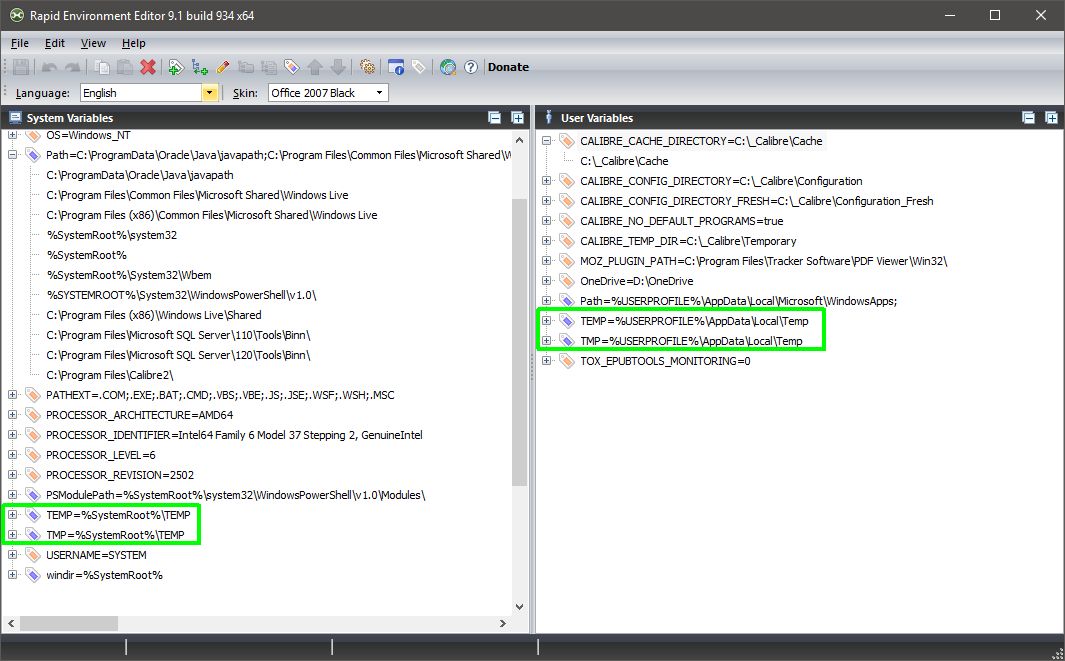

... additional info in case it's relevant ...
The /sysfiles/temp part of my versions of the 'message' fields are my Windows Temp directory which is actually located at D:\sysfiles\Temp not the default C:\Users\username\AppData\Local\Temp
So... it seems you are not a '...a plain old Windows user..."
Might this be the problem?
Could be - in theory plugins 'should' use the same place for their temporary files as the host application uses, but with a wrapper around 3rd party java code who knows.
Calibre's temporary location can be set by the CALIBRE_TEMP_DIR environment variable.
There are two sets of TEMP and TMP environment variables, one at the System and one per User level. I don't why, when, and by what the System ones are used, I've never noticed them at my %systemroot% location. There's also a Temp folder in %windir%
It might also be the Path setting, make sure there's only one entry for Java in particular.
I find Rapid Environment Editor useful for 'managing' environment variables, see attachment.

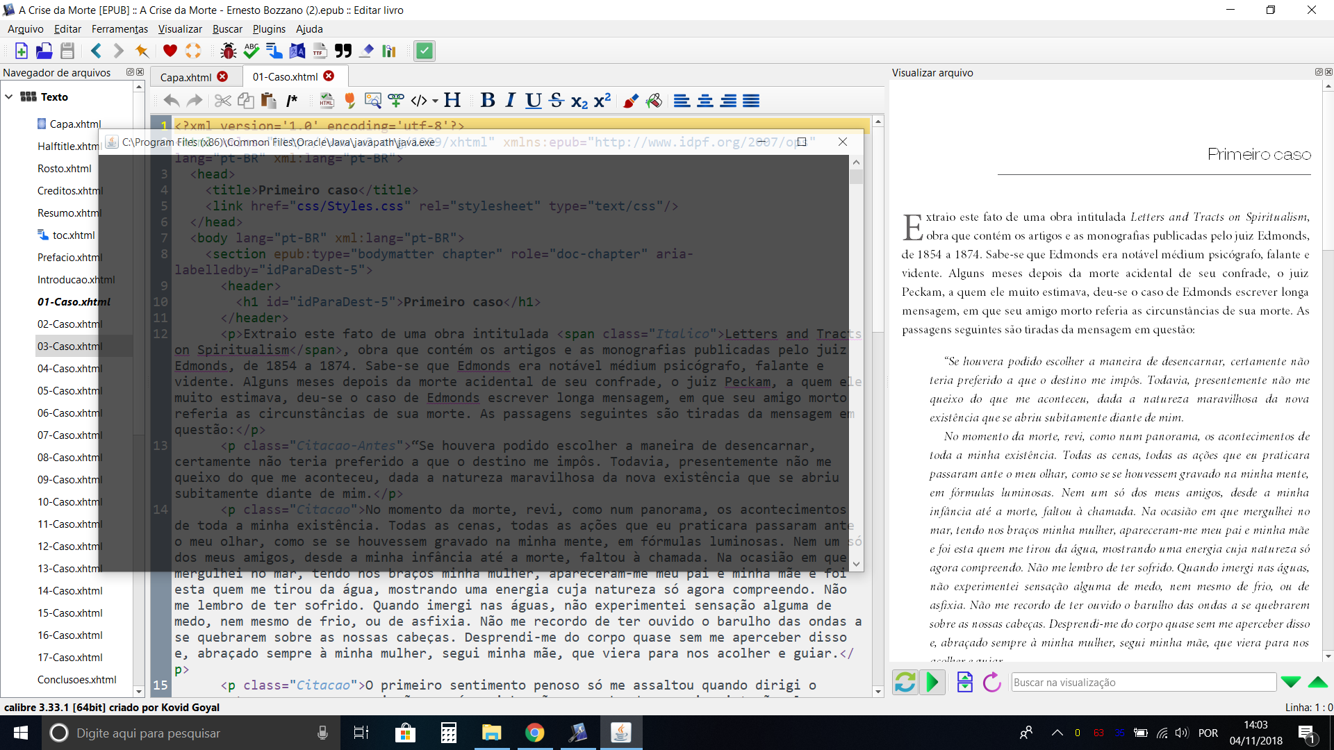

Hi, @Doitsu
Thanks for the great plugin.
Just one question: is it possible to prevent the CMD window showing up when the plugin is running? The Sigil version does not show the CMD window. It looks more clean that way.
I don't see a CMD window on my Windows machine.
Can you please take a screen capture of it?
What's your operating system?
I'm using Windows 10 x64 (1809 version). My Calibre is version 3.33.1 (latest).
The CMD window open shows for two seconds, then closes itself.
thiago.eec is offline   Reply With Quote
Since I wasn't able to reproduce this issue on my 64bit Windows 10 machine with the latest Calibre version, this is most likely an OS/Java issue, which I can't fix.
I've tested it on another machine with Windows 10 Pro x64 (1803 version) and I noticed something:
1) If I open Calibre main program, select the book and click EDIT BOOK, then the CMD Window won't show up.
2) If I open the book directly with the Editor (by right-clicking on the file and choosing the Editor), then the CMD shows up. This happens even if Calibre main program is still running.
This is happening on both my machines.
Looks like the Editor doesn't work independently of the main program. Maybe, when I click on EDIT BOOK, calibre treats it differently from when I open the Editor as a standalone process.
Old 11-04-2018, 11:03 PM   #29
Posts: 45,701
Karma: 28549304
the editor does work independently of the main program. @Doitsu when you call subprocess to run epubcheck, you should specify the creationflags variable to ensure cd window is not created. something like
import win32process
subprocess.Popen(...., creationflags=win32process.CREATE_NO_WINDOW)
import win32process
Thanks for the code snippet! I'll add it to the plugin and release a new version today.
