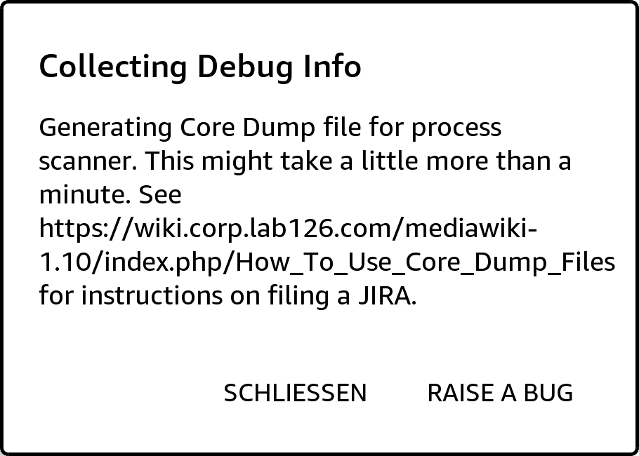

Originally Posted by carp View Post
Hello everyone,
I am new to this forum and I have the same problem as tekkasit, but with a Kindle Voyage:
  • Firmware of Kindle Voyage: 5.13.6
  • Winterbreak 1.4.1
  • Hotfix 1.10.0
When the Kindle is switched on, a pair of files is written every minute. The file names have the following patterns:
  • Indexer_Dump_nnnnnnnnnnnnn.txt (approximately 90 KB in size)
  • scanner_nnnnn_038-juno_1306_icewine_wario-373199.core (approximately 5 MB in size)
("n" stands for a digit)
I can open books, but because the error messages occur every minute, the Kindle's memory fills up quickly.
I have not yet carried out a factory reset. What can I do to get the Kindle working again?
Copy two of those files to your computer, reset your Kindle, jailbreak with WinterBreak BUT use NiLuJe's hotfix
Please PM me those two files, thank you
