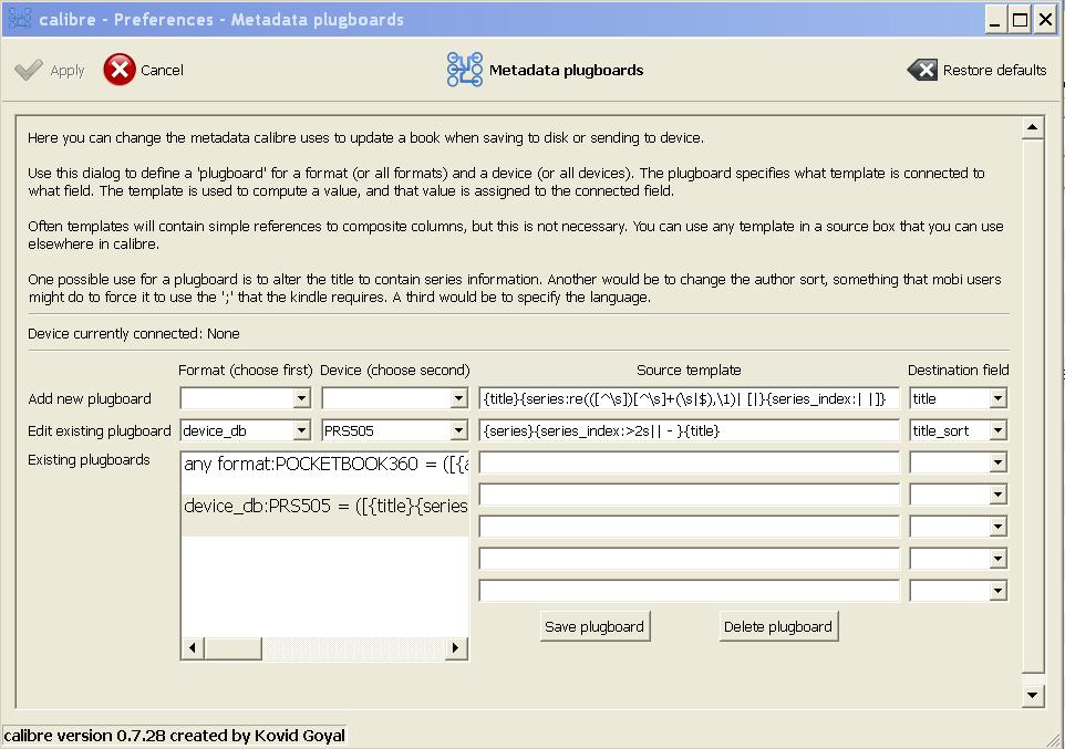

@Ayle,
The Metadata Plugboard in Preferences will let you add the series name/number to the front of the title during 'Send to device'. It works great with my Sony PRS505. When I sort by Author it gives me books in Author/Series/seriesNo/Title sequence without having to make any messy changes in the Calibre library.

@itimpi Do you use calibre or the reader software?
@jackie_w I open the metadata plugboard, not sure how to proceed afterwards
@Ayle, You should probably read this part of the Calibre manual and have a look at this Sticky thread for more info.
This is what I did on my PRS505. I don't see anything specific to the newer Sony models which (best case) means it works the same for all Sony's or (worst case) it only works on the PRS505. I don't know which and I'm afraid I can't test it out for you.
Hoping for the former ...
Open the Preferences - Metadata Plugboard
In 'Add new plugboard', in the 'Format' box, select device_db from the menu. In the 'Device' box select PRS505 from the menu.
You then set up 2 Source template/Destination field entries:
  1. Dest field = title

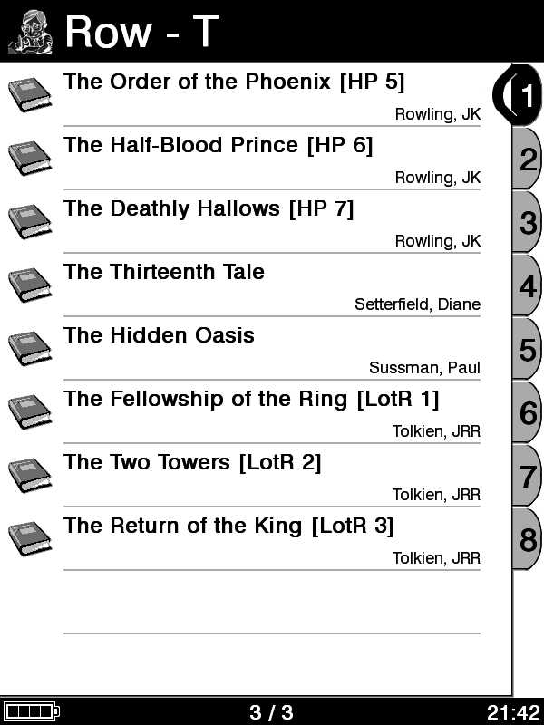

    Source tmplt = {title}{series:re(([^\s])[^\s]*(\s|$),\1)| [|}{series_index:| |]}
    This defines what you actually see as the Title on your Sony booklist,
    e.g. The Fellowship of the Ring [LotR 1]
    I know the template looks horrendous but it doesn't have to be if you want something simpler. I've done mine this way because the PRS505 doesn't have very many visible characters available for the Title. I've attached an image of a page of my booklist.
  2. Dest field = title_sort
    Source tmplt = {series}{series_index:>2s|| - }{title}
    This defines what the Sony will use to sort the Titles,
    e.g. Lord of the Rings 1 - The Fellowship of the Ring
    You don't actually see this field on the Sony but it's used internally.
Save plugboard and click Apply. The great thing is, if you use this option, next time you connect the Sony, Calibre will update all its Title metadata. You don't need to resend all the books.
Try it out for yourself. If this doesn't work on a PRS650 there are other options - so don't despair.
I've also attached a screencap of my Metadata Plugboard screen.
[Edit: Since writing this post I have acquired a PRS-650. It's book list sorting is somewhat different to a PRS-505.]
Anyone with a PRS-650 (and PRS-350???) reading this should also take a look at this thread where I have detailed observed differences.

Thanks jackie_w. I implemented this on my Sony PRS-650. Calibre didn't have a device id for the 650 so I used the 505 like you did. I can confirm that this works.
The 650 has a Collection tab where you can view all your collections. If you sort within Collections by Author then they show up in series order.
