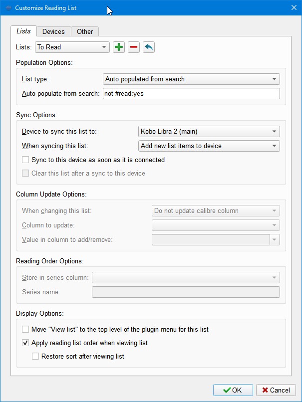

I can't seem to figure out how to properly configure this plugin, so it does what I want.
The best case scenario would be that as soon as I connect my device, it initiates a sync and moves all books from my library that doesn't have a Yes in a custom Yes/No column (called "Read") over to the device. While at the same time, it removes finished books from the reader and adds them to the "Read" list that is tied to the custom "Read" column.
Is that possible?
So far I have the column set up and linked it to the plugin. But I have to manually add new books to the device and manually add books to the "Read" list.

I don't believe what you want is possible.
There's an option to auto-poopulate a list from a search, but that disables syncing.

I use reading list to pretty much do exactly what you want.
The trick is the searches are complicated and customized for my needs.
  • List type: auto populate from search
  • when syncing: add new list items to device
  • sync this list as soon as connected
The search only sends books in certain categories and books not yet read.
In addition to the above, I have a sync rule that marks a book after it has been sent to the device so it doesn't resend it. Some books I delete on the device as soon as I finish reading them. Sometimes I mean to do that and "finish" it instead of deleting it, and those get caught in the next step.
This one I do somewhat manually because I want to manually categorize the read items. I use the 'smart eject' plugin and have a search for "books not on device" that looks for finished books and books previously sent that are not on the device and some other things marking the book on the device as needing updates.
Some of those I delete, some of those I mark as read and possibly remove from special categories of stuff to read quickly, some need cover updates, etc. I have action chains to update some of that.

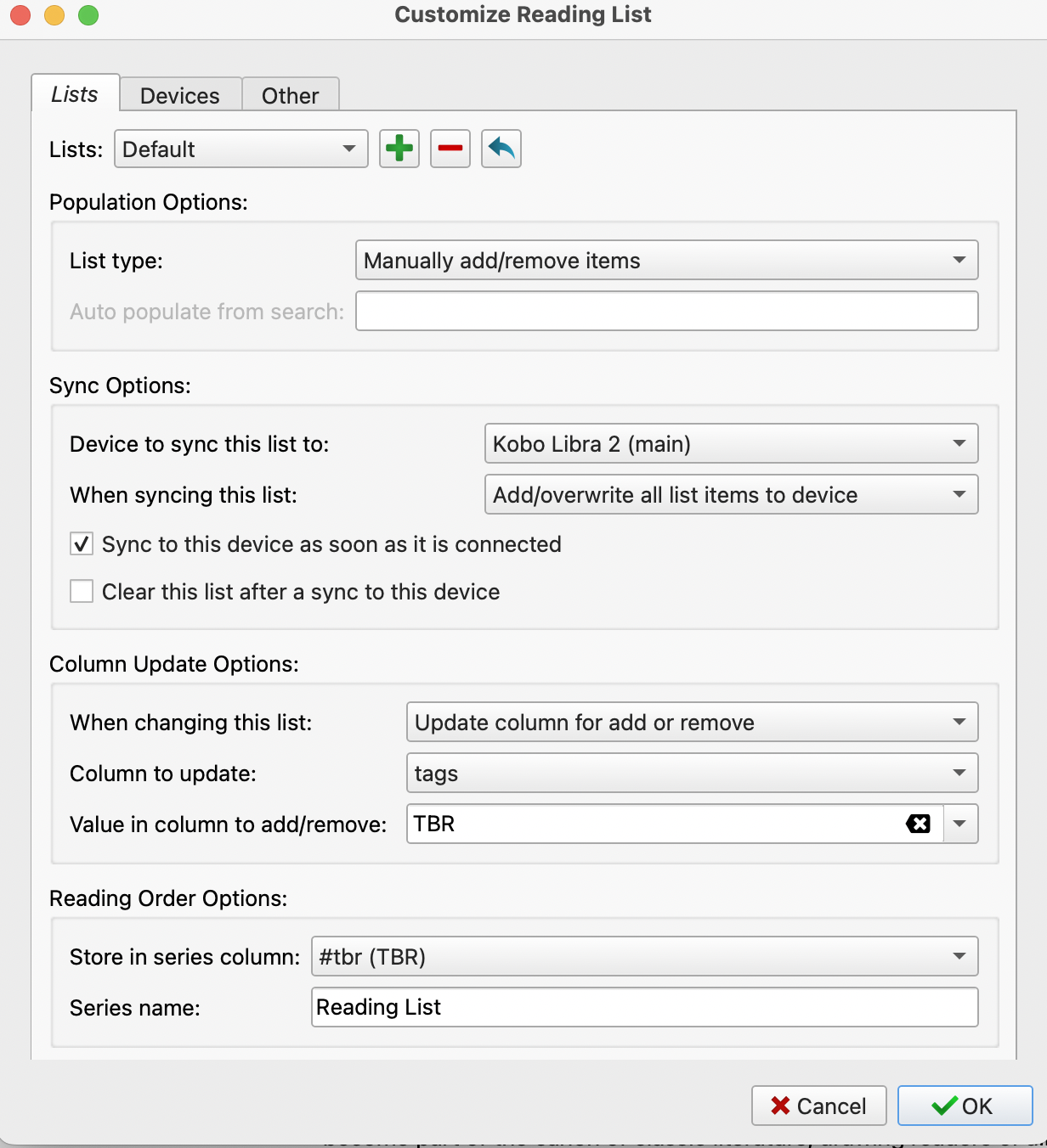

I am wondering if I misunderstood this plugin. I set it up and it seems to be working properly within calibre, but I don't see the reading list anywhere on my Kobo. Is it not meant to also show on the device itself?
If it IS also supposed to show on the device, I have attached a screenshot of my settings for this plugin, in case anyone is able to tell me what I need to do to make it show up on my Kobo too. I did make a second custom series column named "tbr".
I was hoping there was some way to add the reading list as a collection/shelf on my kobo, but have it still be in order.

@Lily7 - no you will not get a list/collection on the device itself. It is purely about creating a list within calibre of books that you can sync to your device.
You can tell Readinglist to add/remove a value in a tag like column and then tell the kobo driver to sync that column to shelves. This doesn't give order though.
compurandom is offline   Reply With Quote
There's a way to fudge the order by editing a date column then using Kobo Utilities to 'restore' the fake dates to device. It's not really worth the hassle, though.
