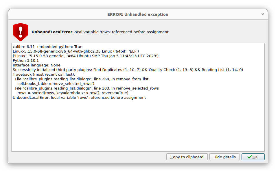

Error when trying to remove book in "Edit List" view
Moving up and down works OK as does using the drop down menu to remove a book, but when clicking on the "X" to remove a book in the "Edit List" view an error is thrown that looks to be an undefined rows variable.
Thanks for reporting that, I will take a look.

Reading List v1.15.1
Release Notes:
https://github.com/kiwidude68/calibr...g_list-v1.15.1
Fixes the bug reported by @coaster71
