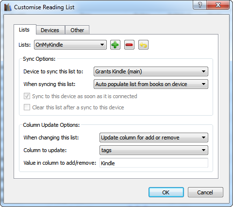

v1.4 Beta
In response to a few things floating around the forums I have spent today experimenting with a new option for this plugin.
Apart from cosmetic changes to the configuration dialog and a new Clear list submenu, the big new feature is the addition of a list type that is auto-populated from the device when you sync to it, as you can see in this screenshot attached. The purpose of this list type is for people who want a way of keeping track of what is on their device while it is not connected. Note that the list is read-only - you cannot add or remove from it, nor you can you edit it to change order. (If you want a list that you can add/remove, then you can instead use the "Replace device with list, add/overwrite all" I added a few weeks ago) As with other reading lists you can specify a column to set/remove a value from based on items being on the list. So in the example shown, I add a tag called "Kindle". So regardless of whether my kindle is connected or not, I can see whether I have already sent a book to the device. If you use calibre's send to device or remove from device directly to add/remove books (rather than syncing via a second list with this plugin), then just doing a "Sync Now" or the device being connected will trigger the list being updated. Please have a play with it and let me know what you think. I haven't found any bugs with my own testing, but I want to get some feedback on how people think it works as a concept. Last edited by kiwidude; 11-21-2011 at 03:33 PM. Reason: New beta version below |

I have 3 lists associated with a given device Add to xxx (add/overwrite all) Remove from xxx On xxx Add/Remove xxx have both boxes checked --sync [immediately] & clear after sync. On xxx now set to autopopulate. A quick test with one book on the Add list: The book was sent, the Add list was cleared, the On list was populated, but only with the book just added, not with the other books on the reader. Disconnect/reconnect and the On list was cleared. Possibly irrelevant info: I didn't create a new "On" list, I just cleared my existing [manually controlled] one, changed the type, and related it to the device. All three lists reference the same tag-type custom column -- each with their own unique tag. Additional minor glitch: When configuring lists the "Sync [immediately] ...." checkbox is disabled when editing an autopopulate list, it is not re-enabled when editing another type list. If this isn't enough info I'll try again bit by bit when I have time. Looking forward to this working! Many thanks! |

@tilia - I think the last time you edited the configuration for the lists in that other library must have been a much older version of the plugin. I have added some changes in to make sure others will not get the same error, thanks.
@capnm - I have fixed the disabled checkbox bug. I also found a few bugs to do with remove lists. It is fairly complex in there now, because at the time I produce the auto-sync list I don't "actually" know what is on the device (since the sending of books to the device is a background job), instead it is "estimated" based on all the list actions you have applied. Let me know how you get on with this version. Thanks for the feedback to both of you, just the sort of stuff I wanted. Last edited by kiwidude; 11-22-2011 at 07:06 PM. Reason: Removed attachment as officially released |
