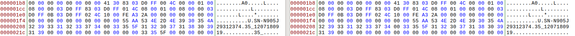

I tried all of those things with no luck. Screen is not damaged and left it charging overnight. Is it possible that I may have mucked something up with the serial number in the image? I'm guessing the iMX5 checks that section and only boots up if that is correct? See attached image for serial number comparison of the image you sent me David, with the serial number modified on the left hand side and the original backup image I grabbed off the SD card on the right hand side. Maybe I'll try removing the 3 bytes at 0x229.

There is no need to enter the serial number; leaving it at zeros works.
Sent from my Pixel 4a using Tapatalk
Good to know, thanks! I loaded the serial-less image, did a factory reset, and am back to the issue I started with: green, blue, and then flashing green for 12-13 cycles. Screen doesn't come on during or after and nothing else happens. Any thoughts? Maybe there's a fundamental hardware issue... I tried looking for what that LED pattern might correspond to but haven't been able to find anything.

My N905 Touch, shows the blue LED on power on, then flashes green a couple of times then the screen starts to change. What you are seeing makes me think the device cannot boot from the card. But, a factory reset will flash the LEDs until the rest is finished.
If it is the screen, it might be booting but not able to show anything. You might be able to tap on the screen and find the right place to connect to the PC. My Touch doesn't have a WiFi setup option. If it is plugged into a PC when powered on after factory reset, it automatically connects ready for setup using the Kobo desktop application. I'm not sure if the N905C is the same as it has later firmware for the factory reset. It is probably the same as the Glo. In case it helps, I have attached photos from my Glo of the first two setup screens. You can try tapping similar positions on the screen to see if you can get it to connect to the PC.
As @PeterT said, not updating the serial number in won't cause a problem. Updating it is better, but, not by much as it is not used in that many places. I suppose that there is very small risk of corrupting the image when doing this, but, it easy to do correctly.
