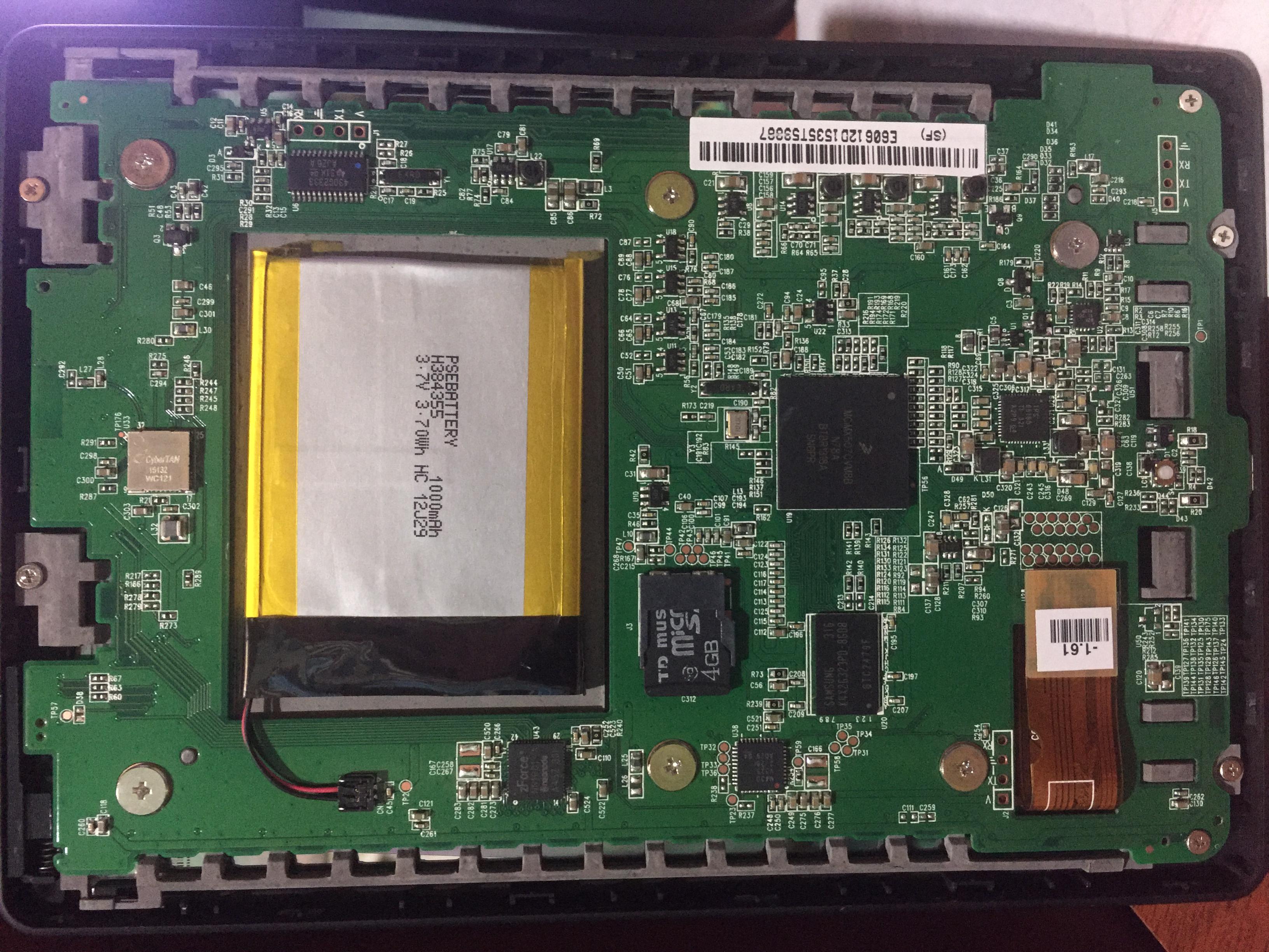

Old 06-17-2020, 02:15 PM   #1034
faraon
faraon began at the beginning.
faraon's Avatar
Posts: 8
Join Date: Jun 2020
Device: kobo glo hd
Good morning comrades
Can you help me identify this kobo and please if they identify me share the SD image to relive it.
Thank you very much and I will be very grateful.
faraon is offline
Old 06-17-2020, 10:27 PM   #1035
davidfor
Posts: 24,905
Karma: 47303824
Location: Sydney, Australia
It looks to be either an N905B or N905C touch.
Why:
  • No connector for the light, so either a Touch or a Mini.
  • Mini is a 5" screen, so I assume you have eliminated that.
  • Having an internal SD card means it isn't an N905 Touch. But, the card is a 4GB card, which was never in any of these devices.
But, the model number is on the end of the device that has the USB port. What does that say? Otherwise, I'm sure there is a model number of some sort printed on the PCB. It must be on the other side. You will need to take it out to see.
davidfor is offline
