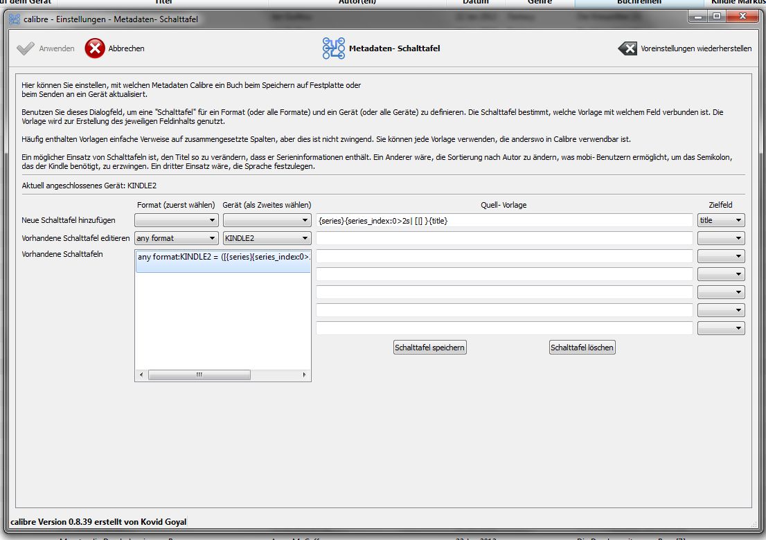

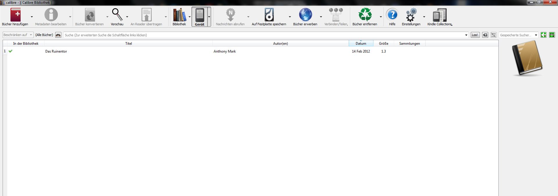

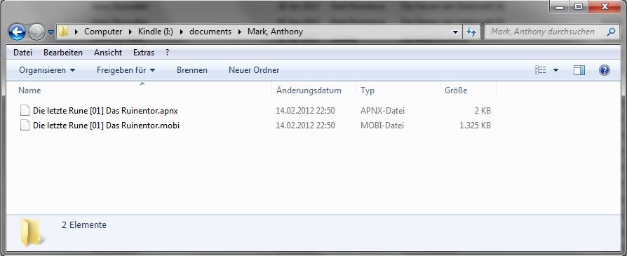

Hello,
I received a new Kindle 4 today and I want to try the plugboard function in calibre to rename and sort some ebooks but for gods sake it did not work.
I use following Template: {series}{series_index:0>2s| [|] }{title}
After I send an eBook to the Kindle the filename on the device is changed but the title is still the same as in Calibre. Please see pictures attached.
*UPDATE*
Now it works! I don't know why, but now all titles on the Kindle are renamed.
FMarkus is offline   Reply With Quote

I had the same problem, but found the answer somewhere on these boards (sorry, can't find the post now).
If the files were originally on the Kindle under their old title, you need to not only delete them from the Kindle but restart it (Menu > Settings > Menu > Restart on mine), then send the new versions from Calibre (Send to Device). Apparently the Kindle can be a bit reluctant to let go of stored metadata.

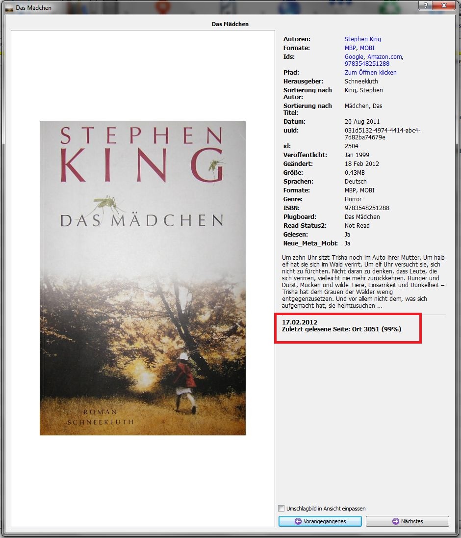

Hello,
I have an issue with the read status in calibre.
I use a Kindle4 and installed the python script and added the column as described in the post from pchrist7. (I uses the kindle_read_status_2)
The reading status is shown in the Meta Preview (pic1) but the custom column only shows not read (pic2).
I used following template for the column:
{comments:kindle_read_status_2(90,Read,Reading,Not Read)}
For my understanding the custom column must show read (or the %) but it shows only Not Read
Edit:
Could it be possible that the python script only checks the english version?
What needs to be changed to match the german language? (17.02.2012
Zuletzt gelesene Seite: Ort 3051 (99%)

German version - kindle_read_status_2
Originally Posted by FMarkus View Post
Hello,
Edit:
Hi Markus
Yes, the examples only works for english status text.
However, here's a German version that should work, at least it does here, using your example. You'll have to modify the template.
Make a copy of the line mg = rematch etc., and insert it below the original line.
Disable the original by entering a # sign at the front
Modify the copy line (or copy from the code below) to handle german text.
Please be carefull you have a TAB in front of the copy line.
#	mg = re.match('.*\s(\d+[-/]\d+[-/]\d+).*?Last Page Read: Location \d+ \((\d+)%\)', val, re.I + re.DOTALL);
	mg = re.match('.*\s(\d+[-/\.]\d+[-/\.]\d+).*?Zuletzt gelesene Seite: Ort \d+ \((\d+)%\)', val, re.I + re.DOTALL);
Edit: Remember to restart Calibre
Hope this works for you,
Cheers Per
Cheers Per
Thanks for your help, now it works.
