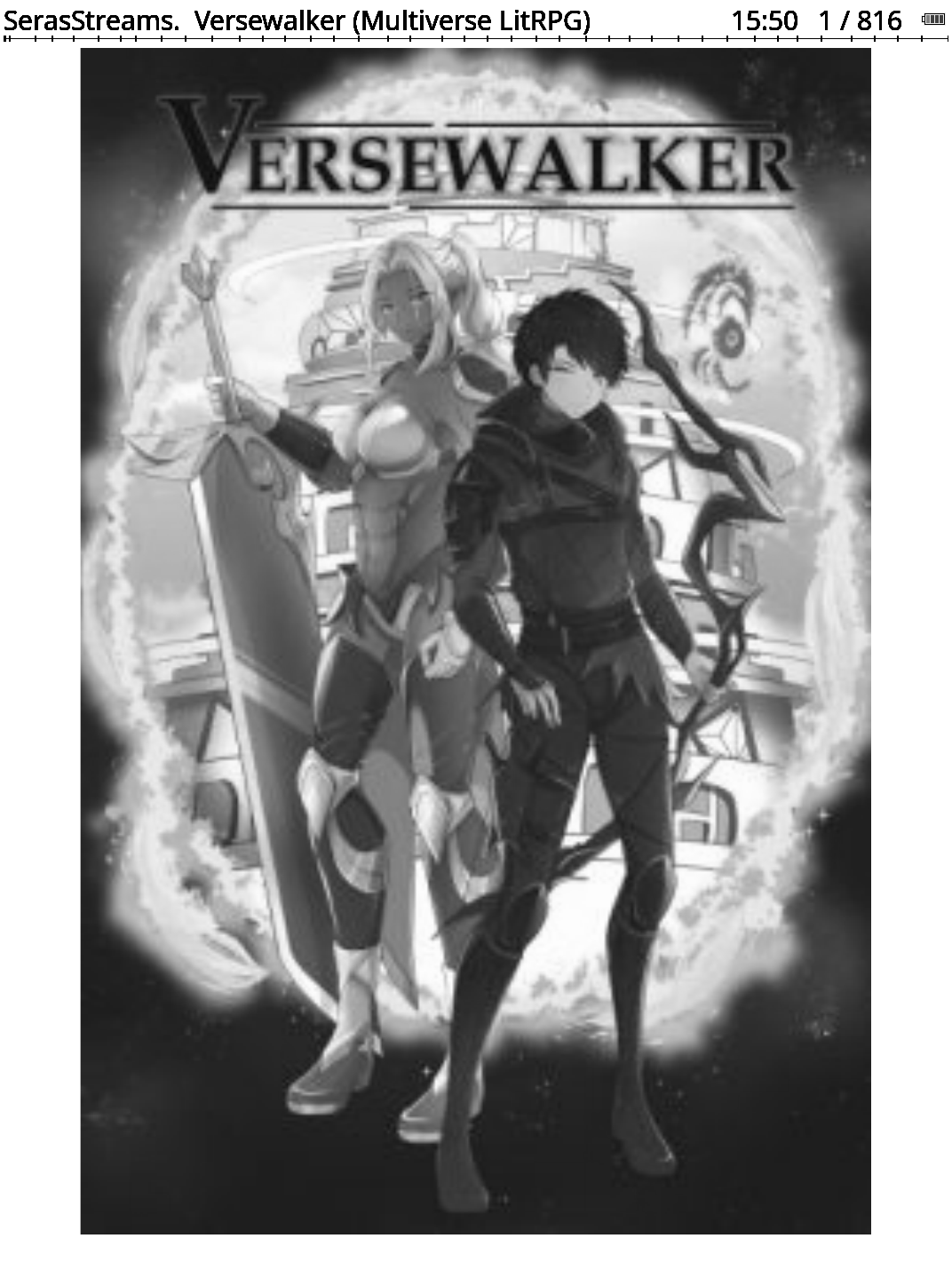

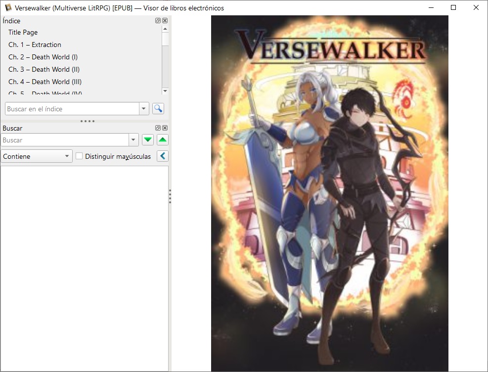

First of all, this plugin is wonderfull!!!
And now with my question.
I have downloaded several stories from Scribblehub. (The conversion was perfect I only had to edit personal.ini to modify the css and add indentation.)
But I use KOReader to read epubs and the cover is tiny.
I have seen that cover.xhtml does not have "<link href="stylesheet.css" type="text/css" rel="stylesheet"/>" and "<img src="images/cover.jpg" alt="cover "/>" has no class.
Is there a way to add that code automatically so later I can tinkering with personal.ini to adjust css?
Thanks.
SFW link
https://www.scribblehub.com/series/1...iverse-litrpg/
Screenshots from KOReader and Calibre reader attached. The KOReader screenshot my appear large but the e-reader actually has only 6''.
EDIT: Sorry for my English, is not my native language.
You can customize the HTML generated for cover.xhtml using the cover_content setting. Changing it to include <link href="stylesheet.css" type="text/css" rel="stylesheet"/> should be easy enough.
See CustomOutput wiki page.
Also, be aware that by default FFF reduces the size of large cover images to a 'reasonable' default:
[epub]
## Resize images down to width, height, preserving aspect ratio.
## Nook size, with margin.
image_max_size: 580, 725
Your example already has a smaller image, so it wouldn't matter in that case.
I didn't know about the wiki. So many posibilities now...
About the cover thing. I only had to change the img line.
cover_content:
 <html xmlns="http://www.w3.org/1999/xhtml" xml:lang="en">
 <head>
 <title>Cover</title>
 <style type="text/css" title="override_css">
 @page {padding: 0pt; margin:0pt}
 body { text-align: center; padding:0pt; margin: 0pt; }
 div { margin: 0pt; padding: 0pt; }
 </style>
 </head>
 <body class="fff_coverpage">
 <div>
 <svg xmlns="http://www.w3.org/2000/svg" height="100%%" preserveAspectRatio="xMidYMid meet" version="1.1" viewBox="0 0 1200 1800" width="100%%" xmlns:xlink="http://www.w3.org/1999/xlink"><image height="1800" width="1200" xlink:href="${coverimg}"/></svg>
 </div>
 </body>
 </html>
And now is perfect for KOReader.
Thanks.
