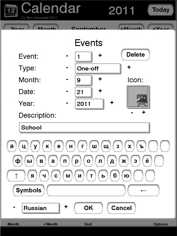

Hi everyone,
Well, for better or worse I have now split the Calendar app into two different versions: touch and non-touch.
The touch version now has the ability to switch between different keyboards on the event pop-up itself. Included: the Western keyboard (now with a "numpad" making use of the expanded keyboard), a Russian keyboard and a Georgian keyboard. You can also have a custom keyboard. Just place a file entitled "custom.kbd" in the Calendar settings folder (where the events file is stored). Make sure the keyboard file is based on one of the other keyboards, and possibly with a little experimentation, you should be able to create a suitable keyboard if the standard ones are not to your liking.
The non-touch version also has a custom keyboard option. The app will create the file (custom_nt.kbd) for you the first time it goes looking for it and doesn't find it. It will be in the Calendar settings folder. Edit this file, and customise your keyboard.
I will be trying the touch version on my 600 soon. But I have no way to check the non-touch version. I am assuming it is OK (since it works in the Sim!) so my next task is to modify the build file and push the changes to the default repository.
Sincerely,
Ben.

In this cases, the non-touch devices have only one keyboard at the same time, and to change the keyboards will be necessary to conect the reader to pc and edit the file custom_nt.kbd. This metod is the same to edit the name.kbd, that was made actully.
Hi Victor,
Yes, unfortunately, non-touch devices can only have one keyboard. I ran out of memory, or something. The program just got too big. (It is because so much computer code is needed to replace the absence of a touch screen!)
The difference with the custom_nt.kbd is that now the file is stored in a place users can access when their readers are attached to a PC. Before, you would have to do a custom-build.
Sincerely,
Ben.
