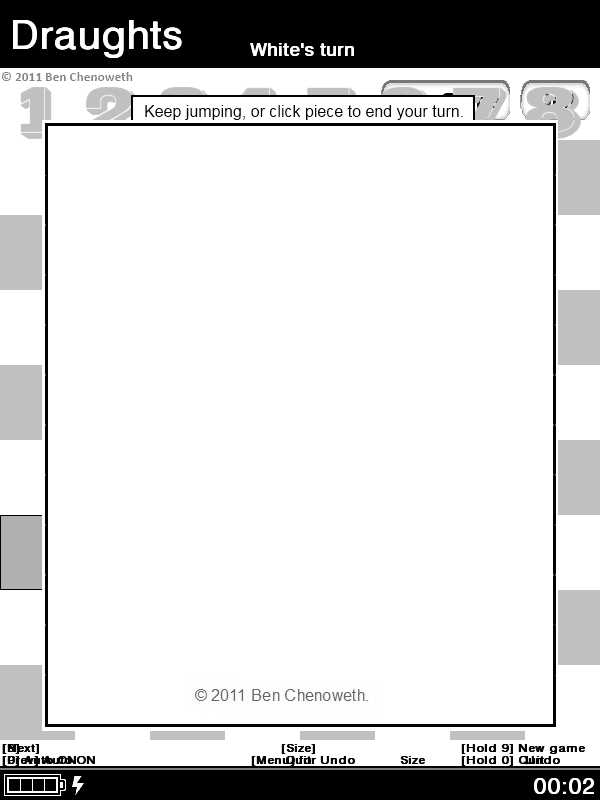

Old 03-29-2011, 08:26 PM   #270
surquizu
surquizu ought to be getting tired of karma fortunes by now.surquizu ought to be getting tired of karma fortunes by now.surquizu ought to be getting tired of karma fortunes by now.surquizu ought to be getting tired of karma fortunes by now.surquizu ought to be getting tired of karma fortunes by now.surquizu ought to be getting tired of karma fortunes by now.surquizu ought to be getting tired of karma fortunes by now.surquizu ought to be getting tired of karma fortunes by now.surquizu ought to be getting tired of karma fortunes by now.surquizu ought to be getting tired of karma fortunes by now.surquizu ought to be getting tired of karma fortunes by now.
surquizu's Avatar
Posts: 411
Karma: 902071
Location: Zaragoza (Spain)
Device: prs-505, kobo auraHD, kobo auraH2O, kobo Glo HD, kobo aura ONE
Originally Posted by BenChen View Post
Hi everyone,
I just finished improving the AI in draughts. At least, I can't think of any other way to improve it. The end result is a little more challenging than it was before, but as the screenshot below shows, massacres are still possible...
The code is in the repository: here.
Sincerely,
Ben.
the last version of draughts does not work in my 505. It starts with the attached screen and it does not do any more. The previous version works well.
surquizu is offline   Reply With Quote
