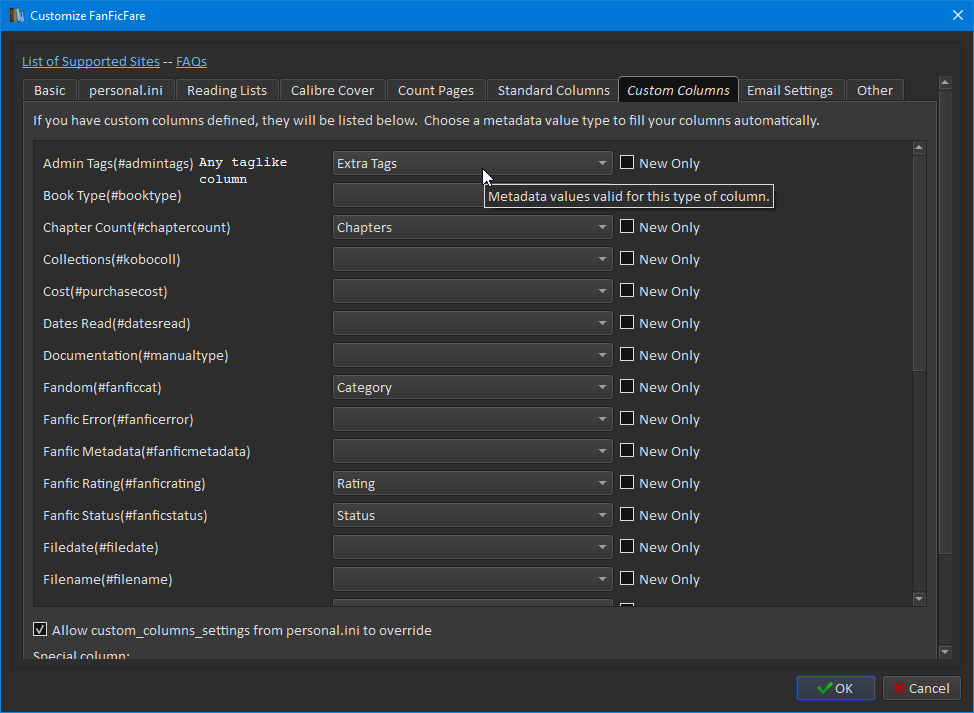

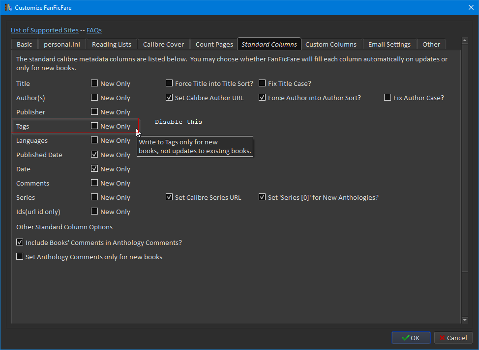

Is it possible to put the tag, or at least extratag (or whatever the equivalent for AO3) in another column than the Calibre Tag one?
I can't seem to figure out how to do it. I've associated the custom column with extra tags, and 'New only' isn't ticked, but nothing happens when I update from the saved metadata column.
I don't know if I just don't have the right field name or if I'm doing something wrong...
Clem2605 is offline   Reply With Quote

ownedbycats
Custom User Title
ownedbycats's Avatar
Posts: 11,380
Karma: 79699999
Join Date: Oct 2018
Name:	2024-08-29 16_27_43-Customize FanFicFare.png
Name:	2024-08-29 16_28_11-Customize FanFicFare.png
Are these set? It's been a while since I set this up so I might be misremembering.
