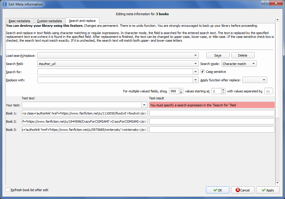

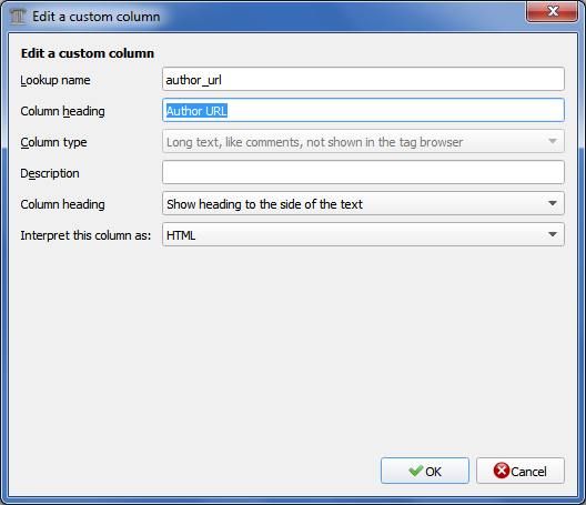

When I select multiple stories I can only edit the comments columns in S&R. The screenshot shows how it looks when I choose my Author_URL column.
Yes, it's a custom column, see the second screenshot. The Story URL column I have is the same except of course for the name of it. I have the following in my personal.ini.
    authorHTML=>#author_url
    titleHTML=>#story_url

Alright, I grabbed a brand new ff.net story in my test database, with those two extra columns. I'm not sure why the initial expression didn't work, but with a few adjustments, I got something that does.
Removing the quotes IE, no extra spaces especially at the end since that'll screw up the regex:
"(.*?)http(s?)://www.fanfiction.net/u/(.*?)/(?s).*"
-or-
"([\s\S]*)http(s?)://www.fanfiction.net/u/(.*?)/([\s\S]*)"
both work fine for me with everything you specified.
Search mode: regex,
search field: #author_url
Search for: (either above option)
Replace with:\3
Destination field: (your choice)
Keep in mind to change /u/ and /s/ for whichever you're using.
Note: I didn't try it with the title (storyID) since it didn't download for some reason and since the author one works fine, I'm assuming the title one will too. If not I'll go back and figure it out.
Nevermind, checked and it works.
