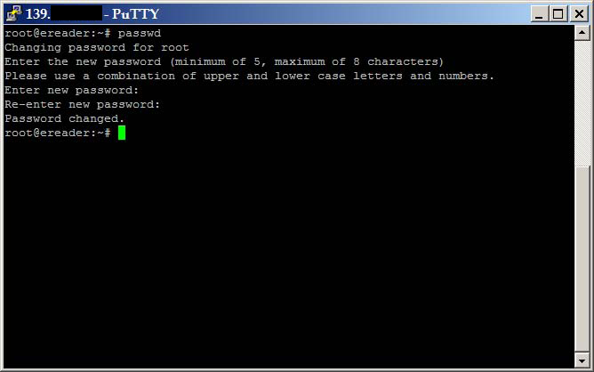

Yamp! I have ssh access to my little iLiad during booting process.
In Windows World I use PuTTY to log in.
I have set a symlink from /etc/rc5.d/S99-unbrick to a /mnt/cf/unbrickable.sh, but script doesn't run during booting. I don't know why.
lrwxrwxrwx    1 root     root           18 May 23 17:53 S99-unbrick -> /mnt/cf/unbrick.sh

is the script /mnt/cf/unbrickable.sh itself executable ?
