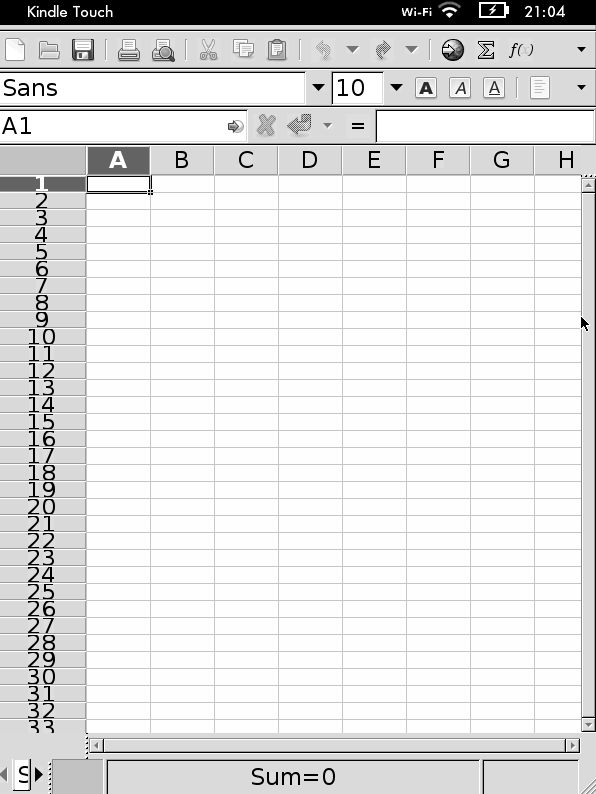

debian - gnumeric
with some love... and a debian.. gnumeric

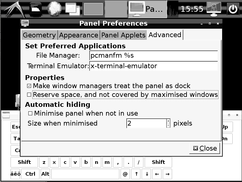

And secondarily the Title attribute so badly needed to bring gnumeric "to the front" natively under awesome just doesn't "work" in the right way. even passing the --name --class or whatever is totally pointless because each subwindow (READ: THE WINDOWS WE NEED) starts up as "Book1.gnumeric - Gnumeric" , "Book2.gnumeric - Gnumeric" etc...
Making the Xephyr option a better solution since at least we can actually START the relevant "contactable" dbus under debian (despite the errors) and get it to the front...

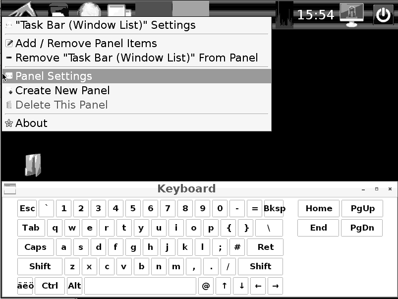

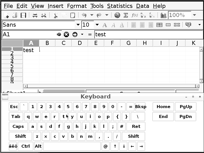

or b) invoke debian / Xephyr with the relevant dbus installed (I have this atm), a window manager, and use an OSK for the data entry. I just gave that a quick test and it worked.
If the OP wants that. I can just give it to them AS-IS. I wont be taking this to building it from code, as I just don't care enough about it. TBH. but it was fun to play with.
There is a WHOLE BUNCH of other rubbish in that debian image right now though.
I would probably recommend just following the DEBIAN ON PAPERWHITE instructions (or my "Step by step" instuctions on the same thread and doing it all via debian.
Added pictures. Hope that helps. I would choose HIDE DOCK
