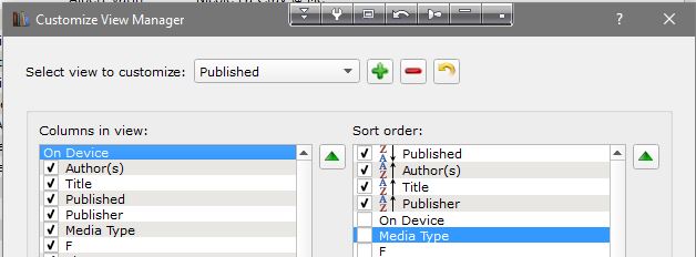

Try this simple test -
Create a view 'Published' with following sort specs
Make 'Published' the current view, and do some column adjustments -add, remove, move, etc.
Select VM->Create new and call it 'Set Location'
Now go into VM->Customise plugin, our objective is to adjust the sort sequence of Set Location so that Publisher ascending is topmost rather than Published descending.

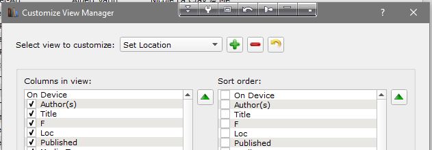

When I select the just created Set Location View this is what I see
I suspect my usage patterns don't meet with your expectations of how and why the new features might be used. I enter all individual 'book' metadata via the book list. That is the main reason I create new views, by arranging the columns in the sequence that is optimal for the source - which are not commercial book publishers. Often as not I want to retain the current sort sequence.
I did that and it behaved exactly as I expected--which isn't what you are apparently seeing.
The only reason I can think of why you are seeing that behavior is if you aren't using the most recent test version.
It should be the same as the last one, but just in case, I've posted the version I'm using here.
