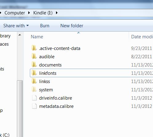

Is Python Folder Created?
@NiLuJe
I'm having trouble getting the Cover mode to work on my Kindle Keyboard (USA; B006). I had no trouble getting your K5 hack to work on my Kindle PaperWhite, but I'm stumped (so far) here.
I was running your .11 jailbreak with SS .29. So, first thing I download the Python package, unzipped and used .01 for K3g. Installed in main directory and updated.
Surprised that it seemed to leave no evidence -- i.e., no Python folder -- which obviously is different than with your K5 hack. Did I do something wrong, or is this the expected result?
I went on and installed SS .31 (over .29, without uninstalling), updated, then dropped Cover into the Linkss directory and restarted. No Overflow directory or anything that I recall from the K5 hack -- but, more to the point, it's not working.
Any thoughts? Should I reinstall the Jailbreak and start over?
Thanks in advance.

@rogerinnyc: It should create a [/mnt/us/]python folder (exactly like the K5 version). If it didn't, something went wrong. Since it requires a somewhat large amount of space (~60 or 70MB), check that you do have some free space on your device .
Yep, if it doesn't find Python, the cover mode isn't enabled, so, nothing surprising there (although there *is* an overflow folder in this version, but it's only used when switching to cover mode from another mode, so it should be mostly empty on a fresh install).
And, yeah, the python update ends up caught in the update trap because it's not whitelisted (I'll probably disable that feature in the next round of update, it doesn't make much sense now, and didn't prove that useful during its lifetime anyway ^^).
So, no, if the update was successful, playing with the jailbreak won't change a thing. (On the other hand, if it failed with a U007 error, then, yeah, you need the latest jailbreak).
I could ask you to check the logs, but there's no error checking in the python update script, since it's not doing anything extraordinary besides unpacking a tarball...

Python Script Still not Working?
As always NiLuJe, thanks for the quick reply.
Still no joy, though. Over a GB of space left on my K3. No error codes in running the Python bin. And still no Python folder gets created.
The attached picture is where I initially place the bin file -- and is also exactly what it looks like after running it (by selecting Update Your Kindle). As I mentioned before, the bin file, after running, ends up in the Linkfonts directory.
Any chance the download for K3g is bad? Or any other thoughts?
The screensaver hack still works the old way (if I load my own photos), but I do love your Cover tweak as it works on my K5.

@rogerinnyc: Hmm. Unlikely that the packages are broken, it's (one) of the device I tested this on ...
I just checked, and there *is* error checking in the install script, so, good news ;D.
So, yeah, could you attach the logs (enter ;dm in the search bar, it creates an all_logs*.txt file in the documents folder)?

@rogerinnyc: Ouch, I messed up my BBCode, sorry. >_<"
Good news though: yes, it helps. The update failed with a U007 error. Your jailbreak isn't up to date .
(On a sidenote, I just caught a bunch of weird bugs in cover mode on my K4, so I'll take a look at those tomorrow, in the meantime, it may not work as well as on the K5 until I figure that out )

@NiLuJe, thanks! And my bad, I guess. I was pretty sure I had run 11N as the jailbreak, but go figure. I'll try again.
EDIT -- OK, up and running and seems to work well once you cycle through your books and create the cache (had one problem where two different covers actually overlapped on the screensaver -- but didn't repeat after I turned the K3 back on and off). Also sometimes the cover doesn't change, even after the cache has been created and I leave the book open for a bit. But those are quibbles, and I'm sure you'll keep improving it, as always. Thanks again!
