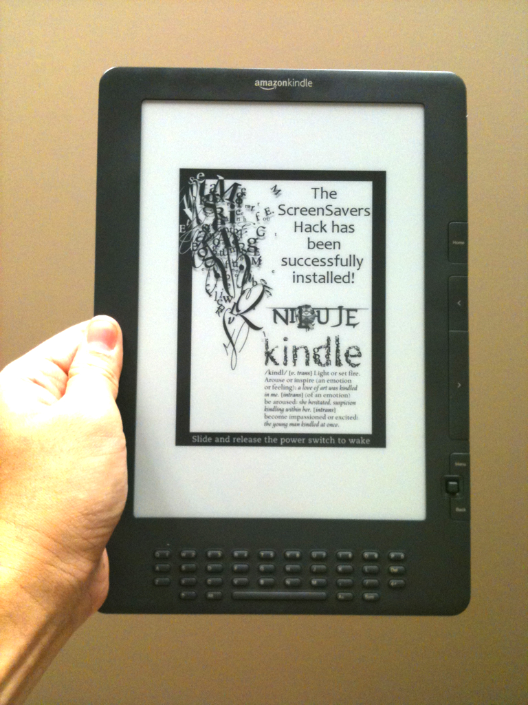

US kindle DXG with 2.5.5 firmware jailbreaks and customizes perfectly with currently posted software - no problem
for new users, just download and follow instructions on first page of this thread step by step.
