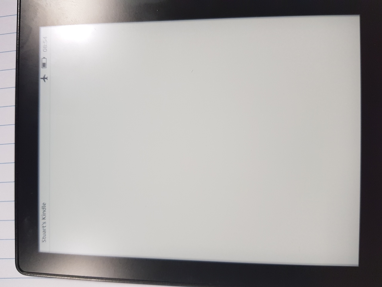

Am running the latest firmware version for an original Oasis - 5.9.2.0.1 - and when i install Kual via mrpackages and ;log mrpi the update booklet, i get the kual.doc but when i open it i get a completely blank page with status bar up the top and that is it - see attached. I cannot access anything at all and all i can do to get out of is a forced restart. What am i doing wrong?

The only thing you are doing wrong is trying to run KUAL on firmware 5.9.<anything>

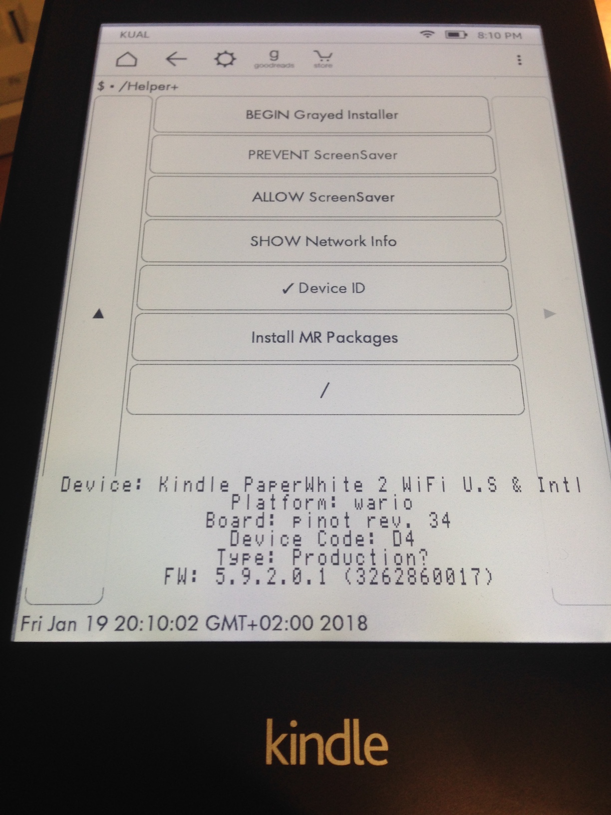

Hello everyone!

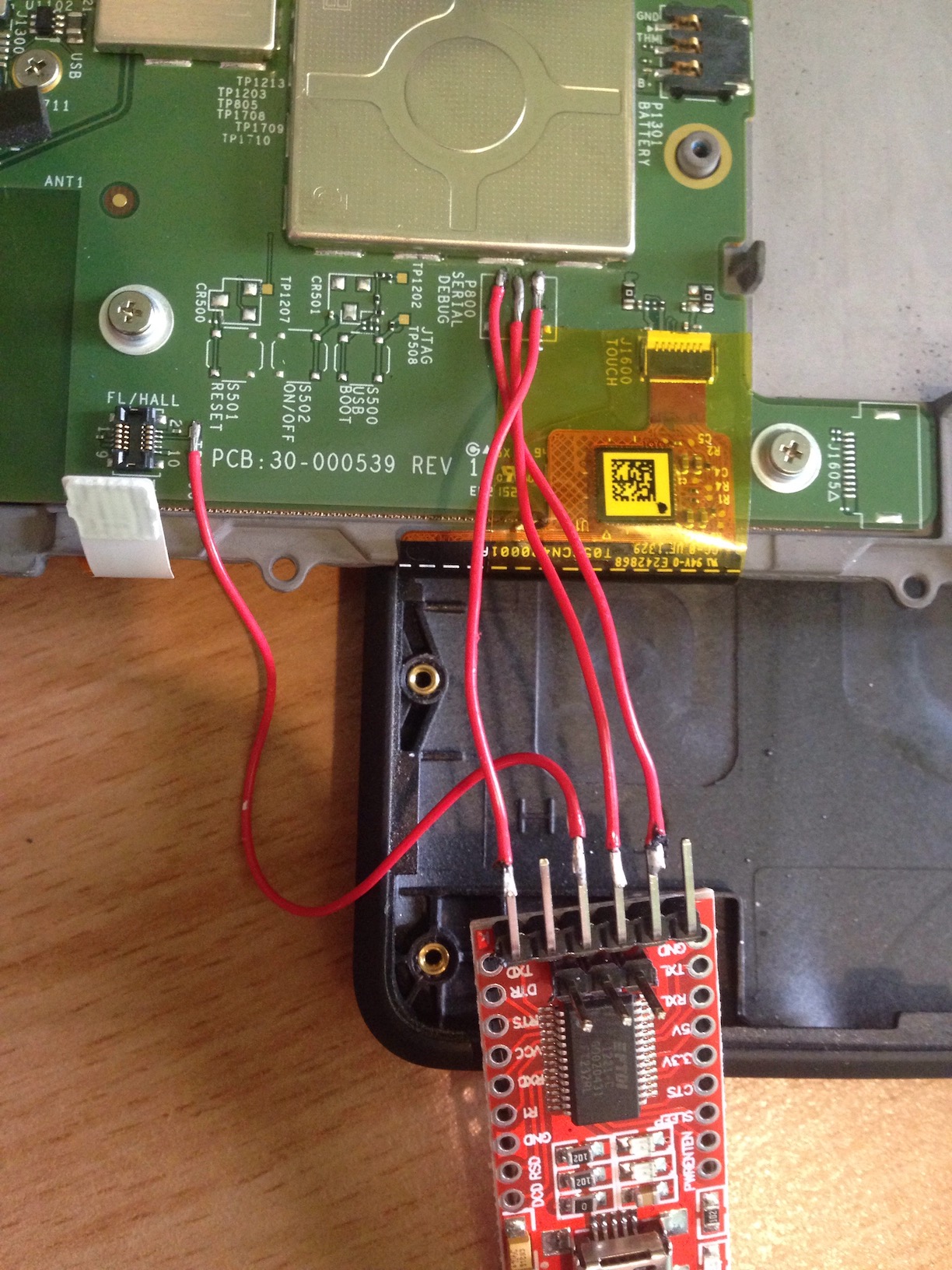

The kindlet(azw2) version of KUAL works great on my PW2, 5.9.2.0.1
Yesterday i did a jailbreak for first time, used a serial method since i was on 5.9.2.0.1. After jailbreak, my next step has been to install the KUAL, and i have been confused, since have seen to many posts that saying that it no longer works on 5.9 and above.
Irenicus is offline   Reply With Quote

The device has been bought back in 10/2013 from U.S. from Amazon, it was the version with special offers/ads (i have removed them today, by contacting the Amazon support).
I dont remeber what firmware version it has from the box. All that time it has updated by itself over wifi, except the last time, when i updated it by myself, from 5.8(dont remember all the numbers) to 5.9.2.0.1
Unfortunately i no more have the exact link, since i have cleared the history of browser. That was 22/12/2017 when i decided to jailbreak it, and the first what i discovered is that a new version is available(5.9.2.0.1), on the kindle the update button was grayed out, so i downloaed it manually, I think from >HERE<
Here is more details about the device
From inside I have only this photo left(with number of PCB)
