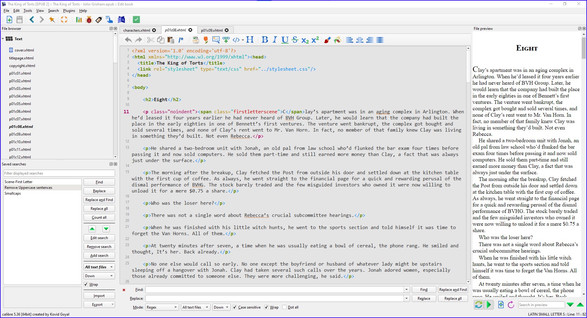

Hi,
I seem to be having a minor issue with the Saved Search box.
In image 1, the box is set to its minimum width when first opened. It cannot be narrowed any further. (It would be nice if we can make this a bit narrower.)
But when you double click on one of the saved searches to edit it, the box expands to the right even more as shown in image 2, and it can't be reduced. It has now defaulted to a new and larger minimum width. It takes up a good portion of the screen.
Is there any chance for a fix to allow reducing the width of the box again.
Thank you

Old 03-12-2022, 05:23 AM   #2
paperback
paperback began at the beginning.
Posts: 76
Join Date: Feb 2022
Device: None
And when you close the box, the file browser does not reset to its previous width; the user has to reset it manually again.

Old 03-12-2022, 04:07 PM   #3
Posts: 21,724
Karma: 29711016
I have a wider Preview and I dock Saved Searches as a tab alongside it.
ID:	192730   Click image for larger version
Name:	Saved Searches.jpg
