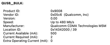

I am trying to root my Boox Nova 3 and am looking for assistance. I discovered that I can place it in EDL mode by simply issuing the following terminal command via macOS:
$ adb reboot edl
From there, I can determine that the device is in EDL mode via both macOS and Windows 10.

Well considering the Nova3 doesn't run a snapdragon 625, there is no reason to think that programmer file would work. Its not necessary anymore anyway now that we can download and decrypt updates, the link is a few posts back
