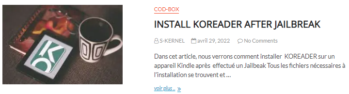

Simple metode to install KOREADER after Jailbreak
• Tested with Kindle 11Gn. PW5 (firmware 5.14.2)
In the first case, I installed KUAL + KOREADER with the BIN + OS Update file, but this method is easier to understand
Name:	Install KOREADER after Jailbreak PW5.png

Thanks, your guides are so useful
