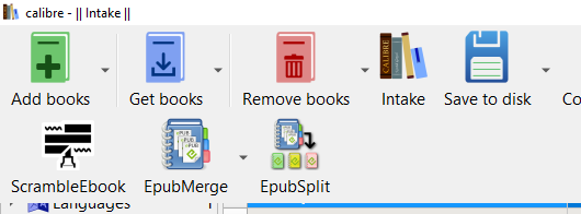

Odd. I don't use the plugin but decided to install it. During the install, it asked where and I stayed with the default Main Toolbar and Main Toolbar with Device Connected. Since the main toolbar was full, I had to click on the widget at the right end of the toolbar to see the icon for EpubSplit. See attached image.
