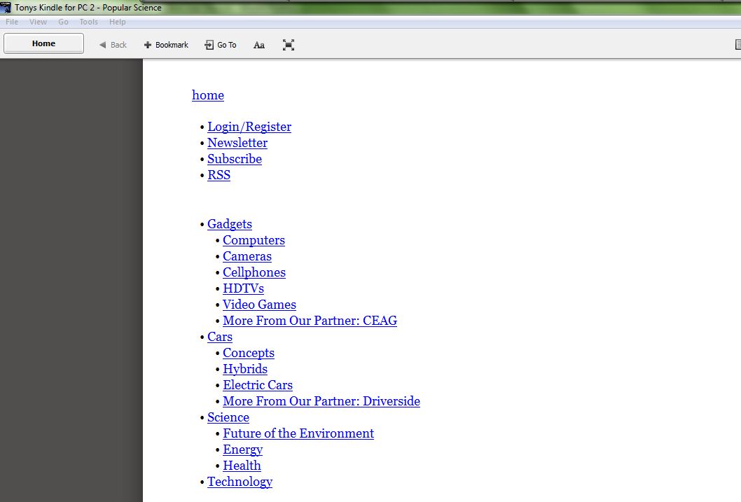

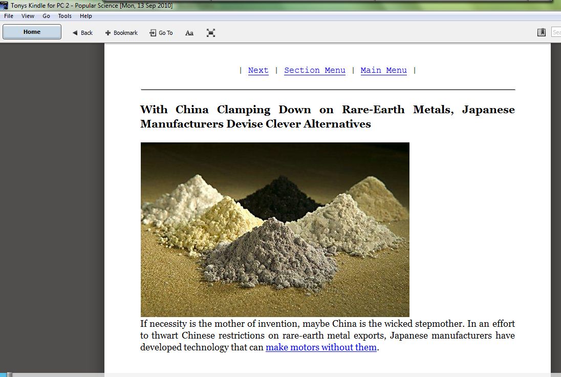

Originally Posted by Starson17 View Post
I'm getting a pretty clean version. I also run Adblock, but that only affects FireFox, not Calibre.
interesting cause look
picture one shows what it looks like when i let calibre fetch the feed.
the second picture shows what it looks like if i build the epub with
> ebook-convert test.recipe myrecipe.epub --test
Name:	junk cap in kindle for pc.JPG
ID:	58164   Click image for larger version
Name:	clean when using test.JPG
The recipe I tested produces nothing like that. I went back to check your post, and either the recipe you posted has changed or I copied the recipe from one of your other posts before testing it (most likely). If I get a chance, I'll go back and test the recipe in your original post.
Starson17 is offline
When I run this recipe at the console with
ebook-convert test.recipe output_dir --test -vv > myrecipe.txt
I end up getting a nice formatted article with no junk.
Then when i take and import it into calibre to fully test it. I get junk.
I can (now) confirm I see it also. The weird thing is that you don't get the "junk" using ebook-convert even when that recipe is stripped down to the absolute bare minimum of a feed and nothing more. The junk on the right side disappears, and the comments on the bottom disappear.
yeah, thought i was going crazy there for a second. I filed a bug report on this.
