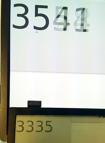

So, I just shot a video and checked. On retrospect, I should have shot at 50fps, but anyway.
I can tell you that the average delay I get is 250ms, with little deviation (owing to the gross discretion).

So tried shooting high speed video, and then realized there were caveats...
So I got this idea: this is (close to) the video you want.
Again, measuring here is not perfect, but I checked a few points of the video and got an average of ~300ms. Sometimes less: see below the screenshot...

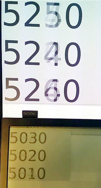

Even better.
Read it "t(0) \n t(-1) \n t(-2)"

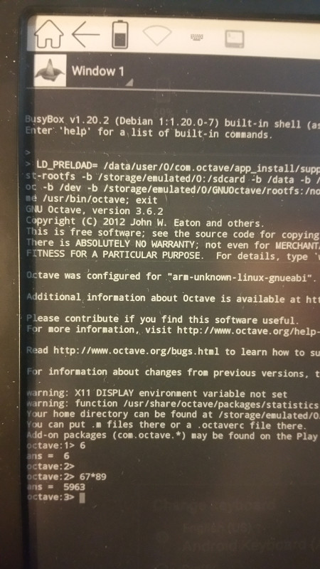

Originally Posted by SnowRipple View Post
@mdp did you manage to train a neural network on Max2?
Wrong thread ; )
Anyway, I mentioned that after receiving the product because I know that Octave runs on Android. And of course it does on the Max2, see screenshot.
But I remember that Fabrizio asked about using python on Onyx tablets, and I believe that the request remained unfulfilled. The mention of termux, and possibly of Gnuroot, should go there. Also considering that maybe he now solved the issue and has pointers.
Let us keep this thread related to general monitor functions.
